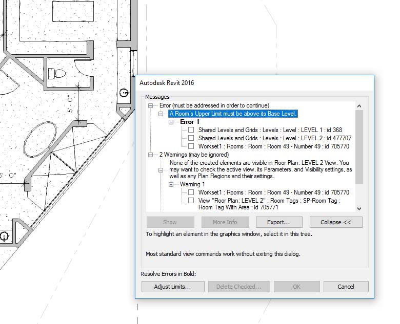

I have a co-worker who is trying to place rooms in his model and he keeps getting a message saying "A Room's Upper Limit must be above its Base Level." I have never encountered this message before. I am attaching a screen shot of the message

my guess is that you have set a workplane in the view other than what it should be. Thats also why you are getting the error for what you have drawn is not visible in the view.
Mon, Oct 3, 2016 at 2:41:29 PM | PLACING ROOMS WITH ERROR MESSAGE ABOUT ADJUSTING LIMITS 2016
Look at the room properties when you go to place it.

and it does not seem to happen when a room is placed on the 1st floor. only the 2nd floor this occurs

From your HELP:
On the Options Bar, do the following:
  • For Upper Limit, specify the level from which to measure the upper boundary of the room.
    For example, if you are adding a room to a Level 1 floor plan, and you want the room to extend from Level 1 to Level 2 or some point above Level 2, specify an Upper Limit of Level 2.

for some reason it was placing my upper limit below my base. it was choosing level 1 as my upper limit when my base was level 2
