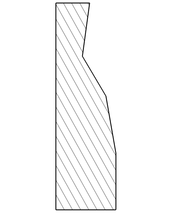

This is a problem I am facing .. please look at the attached .jpg and tell me how do I make a wall that has the boundary shown.

Anyhow it is a non-rectangular wall in plan. ( its faces aren't parallel... )

a way of doing this could be: Go to modelling, then click on create a wall, solid form , by extrusion, where the depth will be the length of the wall, define the z axis, and then describe the section of the wall in one of the elevation views. Untill you can find an easier method you can use the file attached,
