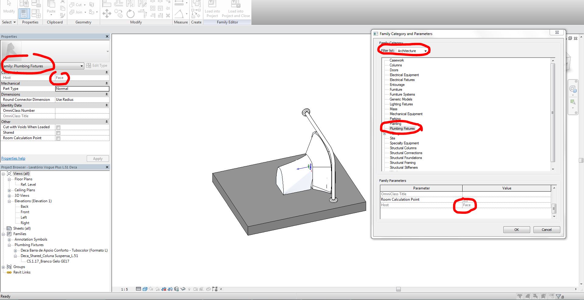

Hey guys. I've found a family from DECA in the internet where its Plumbing Fixture family has a face as host. Inside the family, there's an extrusion which is blocked, I can't copy it to another family, and it is the face host. You will notice that family category is under "Architecture" list and there's a host parameter showing "FACE" (please see attached file "Family").

to create a pluming fixture face based use the generic model face based as a template then once you are inside the family change the category to pluming fixture as shown in attachment
