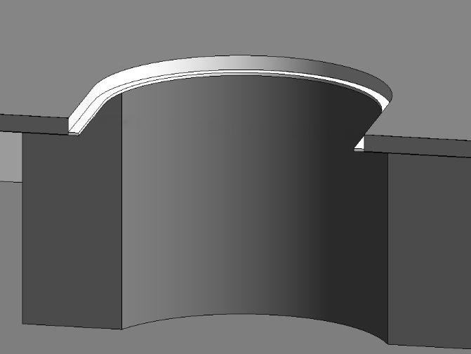

Hello everyone!
Which is the fastest way do you suggest to create a beam of light, following whatever direction?
In my case, I'm approching at the matter trying to create an half-round false ceiling light. I'm not figuring it out!
I'm sure there is a different way from placing, one after the other, small rectilinear segments of light...
Thanks

WWHub, many thanks for your very rapid reply.
Actually, I was already a bit aware of this basics. I would like to know your specific approach to the matter, if you should illuminate a bi-dimmensional irregular path in a false ceiling. Supposing that you've desinged this path directly in your project, as the one in the picture I've attached.
Sat, Sep 17, 2016 at 9:36:27 AM | How to create a twisted beam of light?
Are you talking about cove lighting?
I like to model as it would be built.   In the past, our only option for this was florescent fixtures and so I modeled those in the cove and had the surfaces at a good reflective material.  Now you could probably model LED point source but that would be a lot of lights.  I would probably still model 2' flourescent type, line emitting sources around that tight curve.

Yes, I'm talking about cove lighting. Would you model in place?
Sat, Sep 17, 2016 at 6:30:04 PM | How to create a twisted beam of light?
You have much of the model done except for the front edge which would hide the lights.   The lights would be a light family that has the line light source as described in my earlier links.
