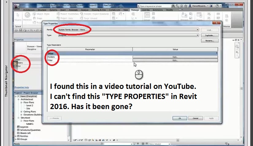

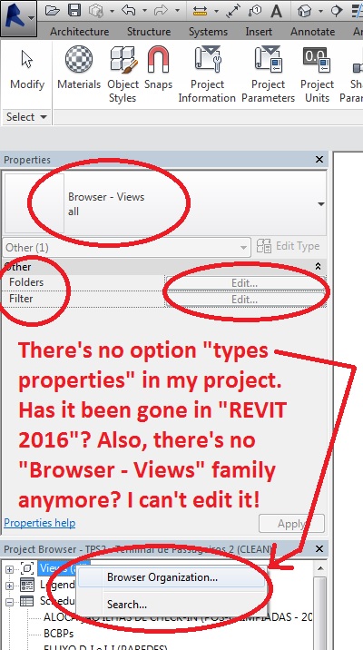

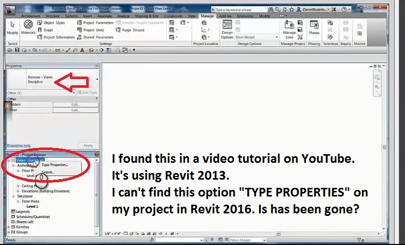

I found a tutorial video on YouTube (https://www.youtube.com/watch?v=y_yQlVFeiMY) in which the guy is using "Revit 2013" where I can see the option "TYPE PROPERTIES" when right clicking in "Views (all)". I can't find it in Revit 2016. Is has been gone?
Also, regarding the System Family "Browser - Views", where can I find it?
Please take a look at the attached images.
Thank you.

Firstly, click the little + symbool to the left of Views in the project browser to expand it. I will assume that you do not have any disciplines set up currently. Type properties only become available after you have made a type using the browser organization which appears for you when you right click on views.
