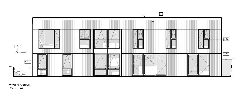

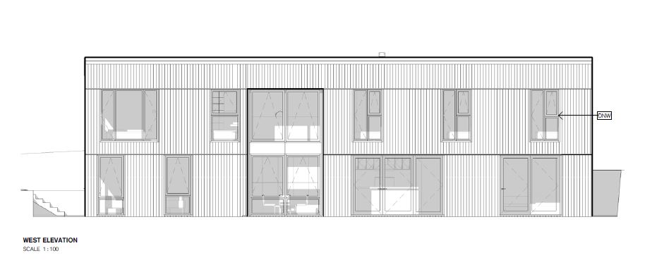

Hi, I am using Revit 2017 and since then I did the change, random keynotes are not printing. I am not sure why when I print the whole file to a pdf some keynotes in elevations are not there but when I print the single page all keynotes are there.
Any ideas how to sort this out please? I need the printing to be reliable!
Attached is an example from what I see in the Revit window and what I get in the pdf
Thank you

UPDATE:
I discovered that if the Sheets that only the sheets that are open will print complete.... so if you want to print the entire 60 sheet file, those sheets that are closed when sending the file to print by using selected views/sheets option will not display correctly.
I hope Autodesk sees this post and fixes the bug Smile
