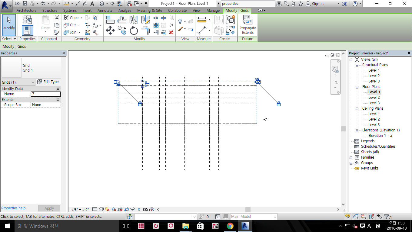

Hello RevitCity,I just began with Revit yesterday and have been following some tutorials.The column line and elevation markers are showing up as this:How can I get the letters and elevation markers to show up? Many thanks,J

You need to load a Grid Bubble family into your project and assign it to the gird lines. In your image on the left side in properties click on edit type and then under symbol in the popup you can select the family you want as the grid bubble.
I have attached one if you dont know how to make one.
