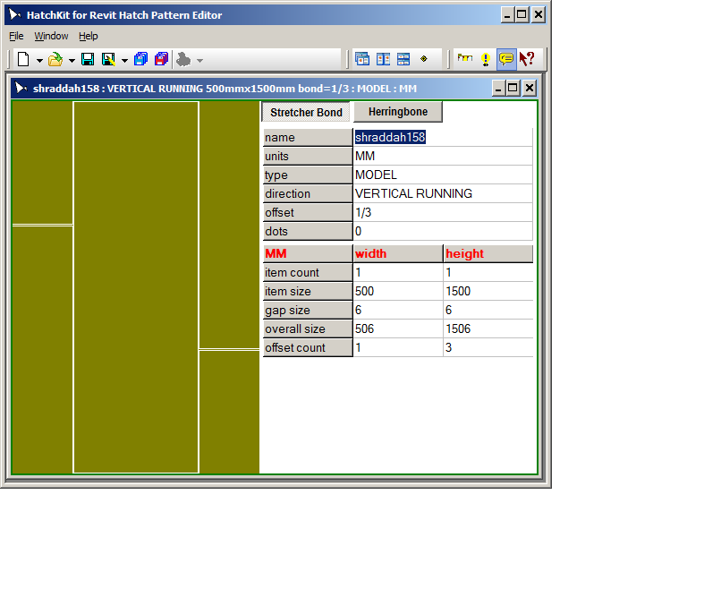

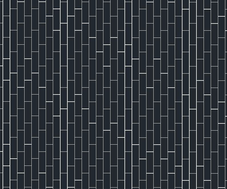

Hello All!
I am trying to make a PAT file for a floor tile that is 500 x 1500mm with 6mm gaps between the tiles.
Can someone please help..spent a few hours trying to get it to be a perfect repeat square in CAD but just not getting there.
Is there a formula that can be used directly in Revit that will make this is quicker process ?
THANKSSS
shraddha

Formula?
For simple rectangular pattern files, I typically find a pattern that is similar and edit the appropriate numbers.   In this case, I might use a 1/3 running bond brick or tile pattern that has the mortar joints.
If you are trying to draw it in Revit to use with hatchkit, then array is your answer.

There is no inbuilt formula ir Revit but HatchKit has a wizard for this
Looks like 1/3 overlap. Try this:
;        Written by HatchKit for Revit
;        HatchKit for Revit (c)1990-2016 Cadro Pty Ltd
;        www.hatchkit.com.au/
;-Date                                   : 31/08/2016
;-Time                                   : 12:35:02 PM
;-HatchKit Version                       : 3.1.8.2681
;-HatchKit Output Filetype               : Revit with HatchKit Add-In
;%VERSION=3.0
;%UNITS=MM
*shraddah158,VERTICAL RUNNING 500mmx1500mm bond=1/3
;%TYPE=MODEL
90,0,0,502,-506,1500,-6
0,0,1500,506,502,500,-1018
-90,500,1500,502,-506,1500,-6
180,500,0,506,502,500,-1018
Hugh Adamson
www.hatchkit.com.au
