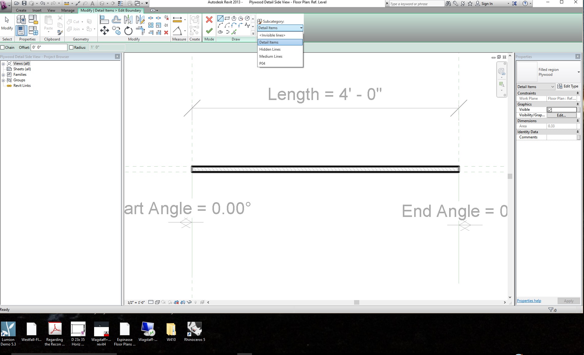

So I have created some detail families with lots of line weights but when i put them into the project and try and edit the family my lineweights are gone.
If I unload family from project, load it again, and immediatily edit i can see all lineweights, then close it edit again and lineweights are gone.
Is the project somehow overiding subcatagories?
Any help would be appreciated.

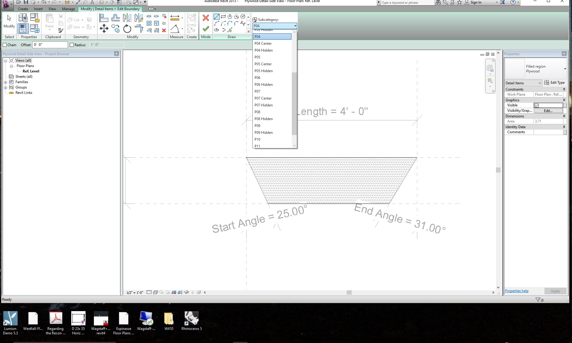

Im a little confused as to why you have so many line styles within your detail item family when it seems that you only have 4 lines drawn in the family itself (2 sides and 2 ends) and then the rest of the lines making the plywood is just a hatch.
Mon, Aug 29, 2016 at 12:59:12 PM | Detail Family Line weight sub-catoagories gone when family put into project
RMutt1917
Joined: Mon, Feb 7, 2011
0 Posts
Every time i want the detail to have a different lineweight i edit family and save as.  Or at least that was my plan. The office is big on lineweights and i m trying to find the best way to control them.

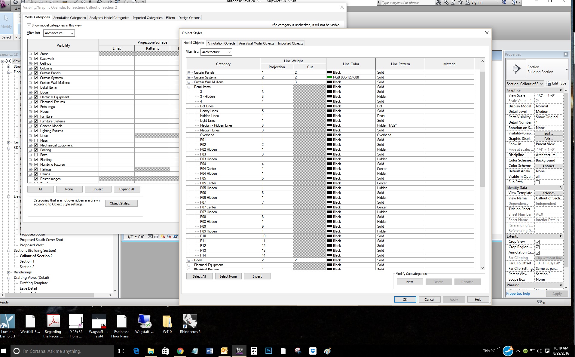

Once the Family’s Object Style Subcategory has been loaded into the Project, you change the line weight through the Project Object Styles -- not by editing the line weight in the family. The line weights that are set in the Project are not over-written  when you change them in the Family and reload into the Project.

I Know, but i am trying to transition this office from ACAD to Revit and all I hear is how terrible revit drawings look when printed. Ergo all the concern(maybe too much) on lineweights.  And i am no Revit expert, so just plodding along.
Ok, so let me get this straight.
Once family is loaded line weight is controlled by object styles per view.  Got it. From here whatever I named the line weight when I created the family I can change it in Object Styles and it will change all the corresponding line weights in the view.
And if I want to change lineweight of the entire object, I rt click and go to Override Graphics in View.
So Basically draw everything first and go back and adjust lineweights as needed.
Why the hell did I make all those subcatagories? Let me try and answer my own question...so i can have all those lineweights to choose from when making my detail family, which kind of doesn't matter since i can change lineweights in each view.
Clarity, I think.
Thanks All

I can understand why you may want a lot of flexibility but now that you understand a little better, you may want to rethink your naming.   Instead of having a large number of linetypes that are specific in name to match their thickness, you may find that a more generic name like thick/thin or narrow/wide etc is far easier to understand and use.  If you build all of your families with this very large group, you will be living with them a long time.

There’s another advantage to having Subcategories.
Subcategories provide the means to control the visibility and graphics of particular family elements in a project view, as well as to be able to easily identify those elements by their unique Subcategory name in the view’s VG dialog box.

I agree that sub categories are a good thing and I use them, just not to the degree shown here.   But if you are going to change a "PO1" line to a #2 pen in VG that will be confusing.  That's why I recommend the Thin/Thick type of labeling.  All of your detail should easily conform to that concept with just a few pens.  You will want to keep the stock ones as primary because of the libraries.   And when you find the stock Detail/Thin really needs to be a #2 instead of a #1, you can set it in your template (Object Styles) and fix the current and future documents.
