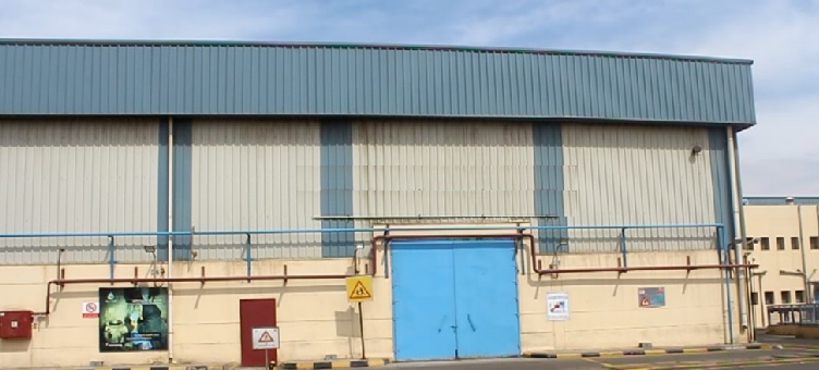

Hi Evryone,
Can anyone tell me: how to model the roof in the attached pic?. It’s 40cm offset from all sidesthanks
Mon, Aug 29, 2016 at 8:23:19 AM | creating unusual roof
marmiketin1
Joined: Wed, Aug 19, 2015
0 Posts
4.5 Stars: 10 Votes
You can either use a wall type for the roof edges or a fascia. This is a vert typical roof edge and is not difficult to create
