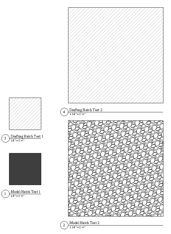

I've been searching forums and have not found an adequate answer for my quandry:
I want to rotate some of the "Drafting" hatch patterns.  Anyone know the code for the *.pat file to do this?  I'm not interested in making them "model" patterns, as every forum I've read states, as I want them to scale along with the details.
As an example, pattern "Earth", in AutoCAD, is "standard" at a angle but our standard utilizes both angled and vertical/horizontal linework to differentiate topsoils vs. fills.

Wed, Aug 24, 2016 at 3:22:06 PM | Revit Hatching
JHARevit
Joined: Fri, May 6, 2016
0 Posts
1 Stars: 1 Votes
Your very important point is irrelevant to my post's inquiry.  So I've attached a screen shot to clarify my intent.  All boxes are 3'-0" square.
There are instances where we want the hatching to remain consistent (in the printed state) regardless of drawing scale.  Is that not the definition of a "drafting" pattern?  As you can see the Model Hatch fails miserably and is therefore completely unusable for the purposes of this post's inquiry.  I made that clear in my first response.  But, I'm guessing this is where you tell me I don't understand, am old, or some other troll-like insult and that the best way is that I'll have to create multiple versions of the same hatch to accommodate the various scales and orientations.  To that I say Revit-0, AutoCAD-1...

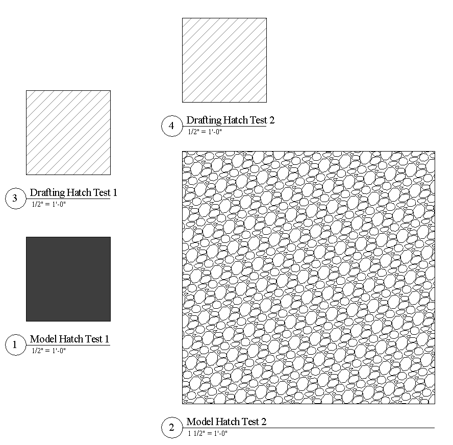

Wed, Aug 24, 2016 at 3:23:36 PM | Revit Hatching
JHARevit
0 Posts
1 Stars: 1 Votes
It would help if the attachment was correct...so here it is

Based on your responses you don't have that problem because you, or your firm, has already spent countless hours developing multiple copies of model hatching to accommodate all scales, views, etc..  I'm not interested in wasting my time making up for the failure of the Autodesk programmers.  I'll continue my hybrid approach utilizing the best parts of both programs.  Maybe someday Autodesk will realize how dumb it all is and make a truly well-thought, intelligent and intuitive program.
