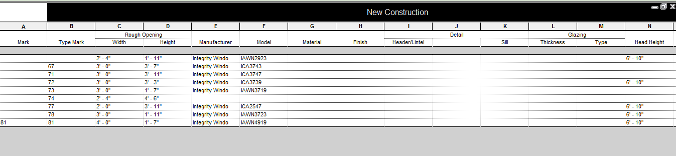

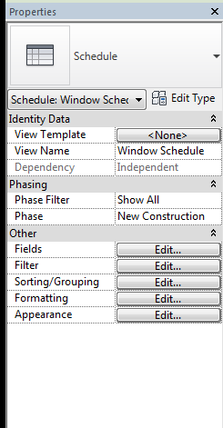

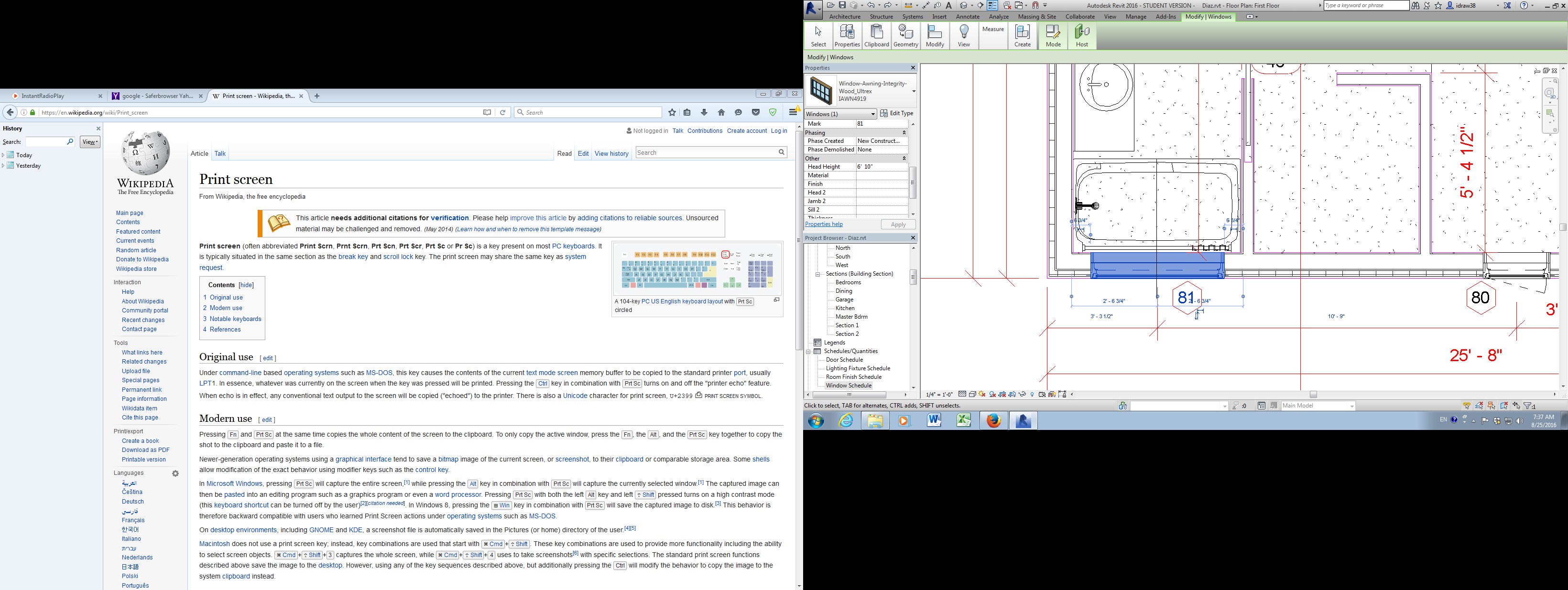

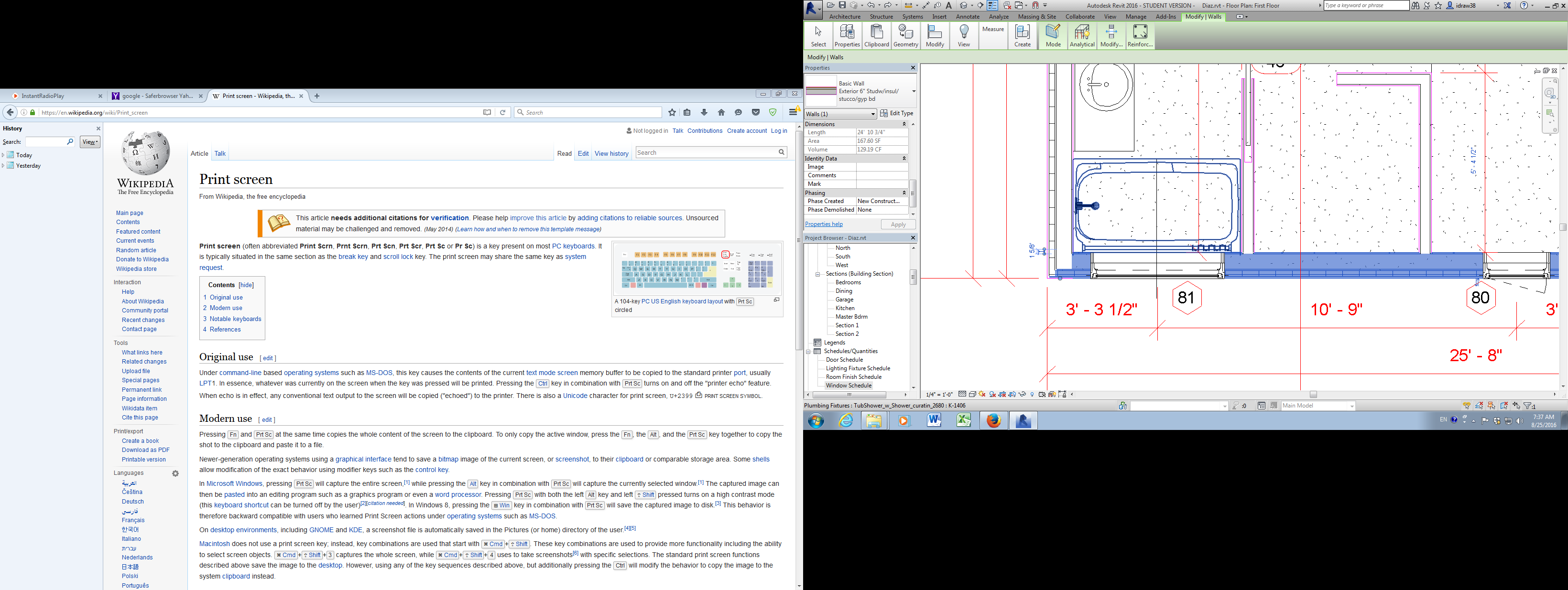

Here are the screen shots. The wall and the window are both new construction.

Did you know you should have a snipping tool that will allow you to just window and area of the screen to capture and image?   That works a lot better than the screen capture.
You did not show us the schedule and schedule properties - we need to see that.

Tue, Aug 30, 2016 at 6:32:05 AM | window schedule
#12
Now I am lost.
You wrote "...Windows are not appearing in the schedule correctly or not at all....".   Your window in plan is #81 and that clearly shows in your schedule.

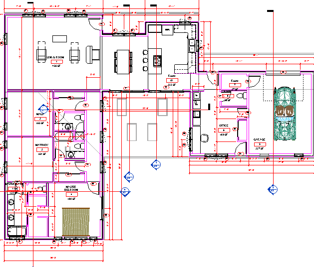

Yes. Some of the windows appear in the schedule. but windows 82-94 do not.
Tue, Aug 30, 2016 at 5:14:42 PM | window schedule
#14
We are trying to help and I asked you to post some images of the window and I assumed you would post the window that doesn't work.   Posting the window that does work doesn't show us the problem.
Tue, Aug 30, 2016 at 9:12:53 PM | window schedule
#15
integrity
Joined: Tue, Nov 18, 2014
0 Posts
Here is a picture of window 86 in the floor plan. Is this what you want? It is not in the window schedule.
