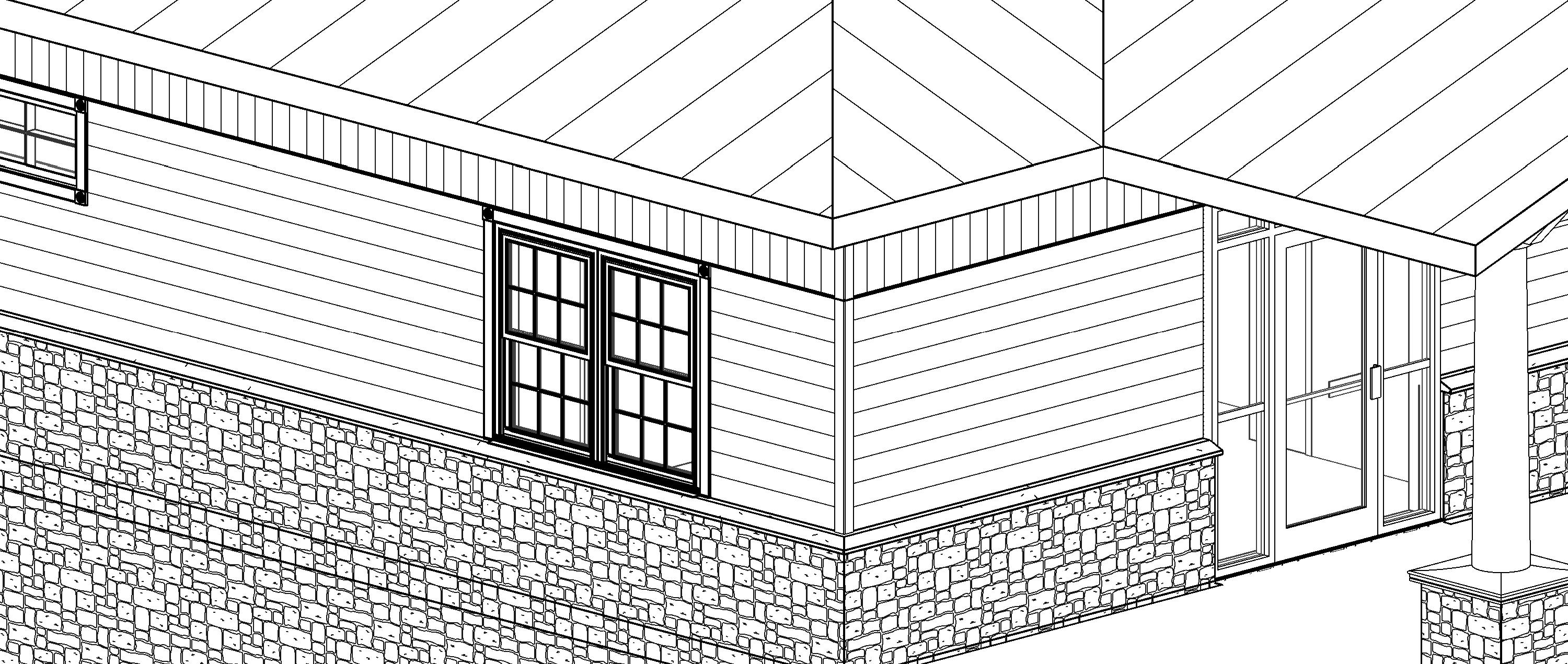

.........the window is in the project now.  When I try to insert a new one or copy that one to a new location, I get the can't create window in wall error message.  The window family and an image of the one that is in the project is attached.  Why would a window family stop working but have one of it stay in the BIM?  Thanks in advance for any advice.

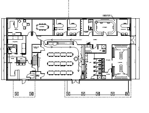

I went back one day to an earlier save of the project and the window inserted just fine.  The client decided (for the second time) that he wanted to mirror the floor plan.  So the project mirrored east to west is the one I am having problems now inserting new versions of the window while "already inserted before the mirror" versions sit there in the project laughing at me. This is the second time this project has been mirrored.  No problems at all like this the first time.  Why would that be a cause now.
I know stacked walls can do wierd things in Revit.  Is mirroring one of those things that wierd out Revit?

I already did a crude version of your suggestion and found the "offensive" element.  I deleted all of the "trim" and the window inserted just fine.  I then went back and deleted the trim one item at a time, tried inserting the window, until I found the "offending" item.  It is the little trapezoid shaped flat sill flashing that is intended to lay on top of the precast sill sweep that is in the stack wall.  CryingSee image.) Omit just that one item, the window inserts.  That item is in the windows that have stayed inserted into walls in this project too and they will move in that wall with no problems. So that is still a mystery.
Another wierd thing happened during all of this.  When I deleted the sill flashing, inserted the window into the project, some (not all) of the other jamb and head trim pieces had shifted to the interior 2".  In the window family, they were still on the surface of the wall just like they always were.  In the project, they moved 2" to the interior.  I had to shift them 2" into the family wall to get them to locate on the surface of the project wall.
So, deleting the "offending" sill flashing fixed one problem but created a new one. (How can that be user error?!?!) I have had stack walls do wierd things in the past but I thought Revit had fixed those problems.  Do windows with a bunch of added elements become wierd after you mirror the project more than one time?

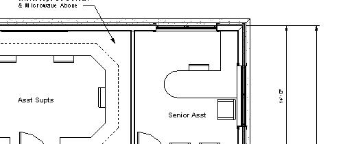

So, I inserted the window with the sill flashing omitted, then shifted the trim into the family wall so all of the trim would appear flat on the project wall.  That is the window in the image on the north wall.  The window on the east wall WAS the original window WITH the now offensive trim that was existing in that wall with no problems.  So, I want all of my windows to be the same family so I did a "match type properties" to change that window to the new window type.  You can see the results.  That shift of some of the trim that I had to compensate for did not happen in that window.  So, the trim shifted 2" into the family wall in the family is 2" into the project wall on the right and on the surface of the wall in the top one.  They are "supposedly" the same window.
Can you see the "doing the same thing over and over and getting different results" conundrum here?  Or maybe I'm just delusional.  Is that it?

Wrong image.  Here are the two windows instead of the entire plan.
