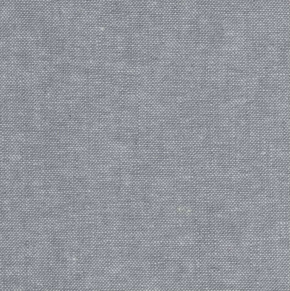

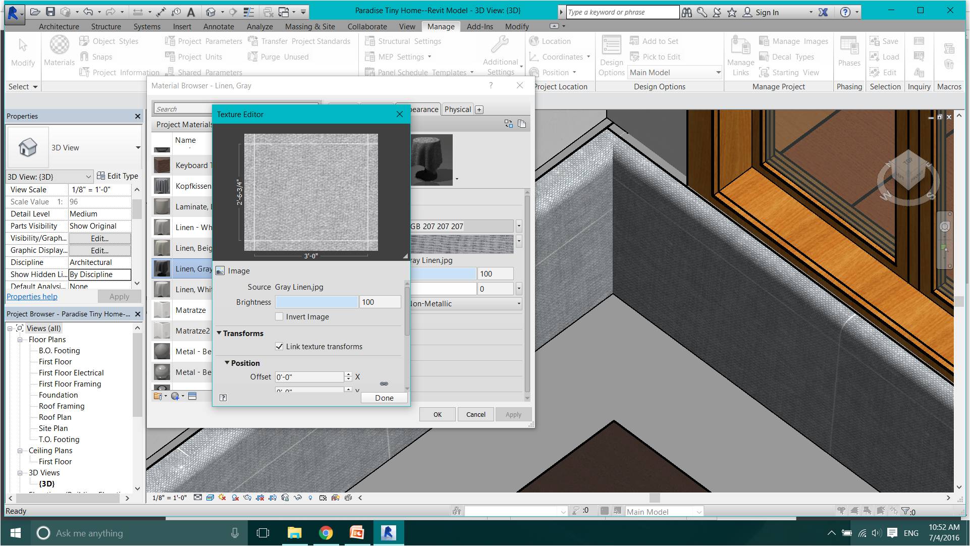

I am having an issue with there being lines in my materials when I create my own. I made sure that there were no gaps when I saved the picture of the image, but when I upload it into the manage materials, it creates a white line so that the material is not seamless. Is there a way to fix this issue?? I have attached a picture of what I am describing.
Thank you!!

Post the jpg material image by itself.... Not the Revit material.  We need to see the source.

It is doing it with any material I save and upload to Revit myself, but doesn't happen if I use a material in Revit already.

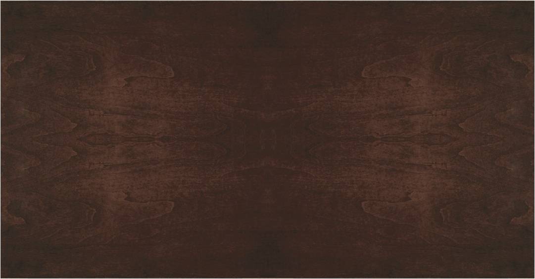

Here is another example

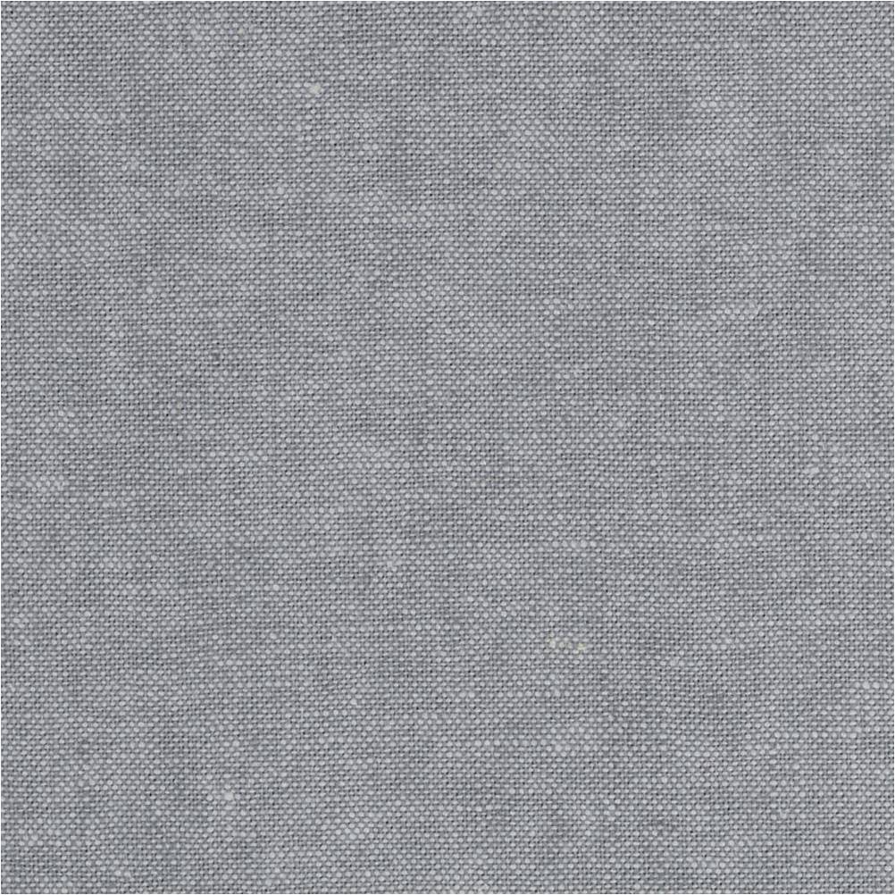

in both of your images there is a very thin white boarder around the actual meterial. you need to remove this and the image will be good to go.
I fixed the linen one for ya
