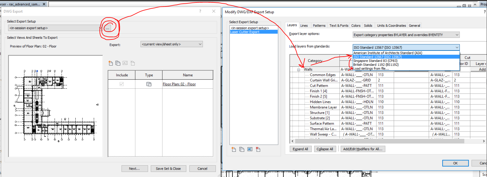

Sure, you're exporting it as CAD anyway right?
Is your laser cutter by color or by linetype?  Associate your wall's CAD linetype to the appropriate colors, hit save and away you go!  This will probably take some time since you're customizing the palatte, but you can easily save and export it to your other computers as well since you can "Load from..."
<see attached>
Cheers!
