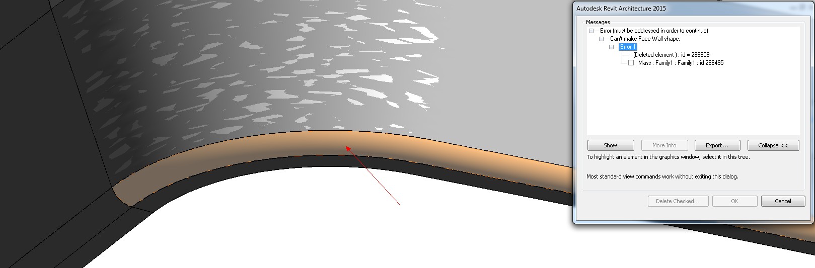

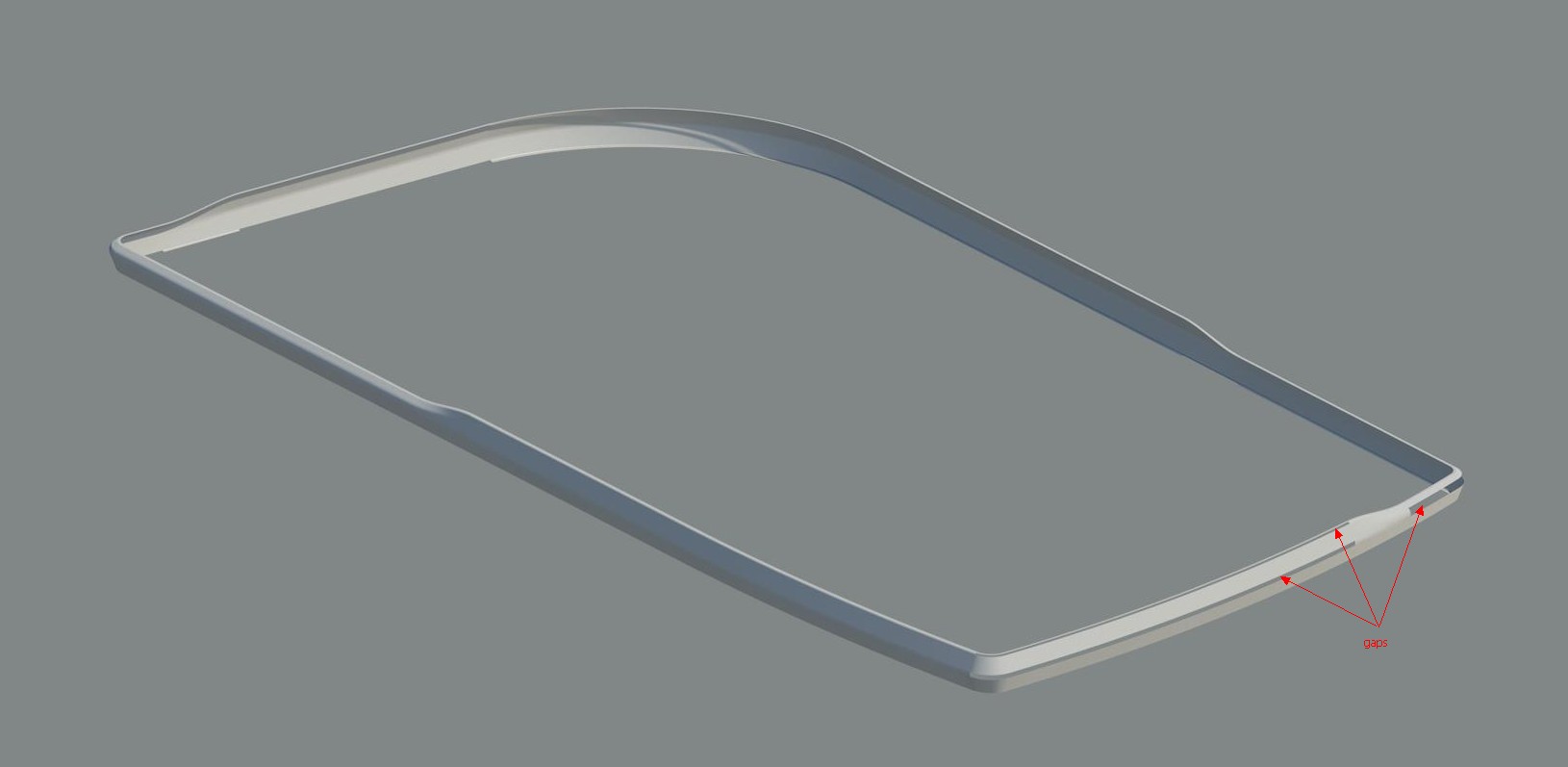

     I'm a beginner to Revit(2015) and to this forum so i hope i'm doing this the right way. I modeled in rhino this parapet and imported it in Revit family mass. Now i'm trying to use "walls by face" on the imported object. Some faces work and some don't. They give me errors or i just can't click on them at all, they don't highlight.
Any ideas or suggestion ? Maybe a different way to model this in Revit 2015?

I'd say part of the problem is the wall type you are using. If it's too thick to make all those sublte bends it might give you problems. Start by using a very thin wall . . . .

Yeah, i thought of that after i looked up on the forum for similar problems and tried it with walls thick as 5/10/20mm and still ...
