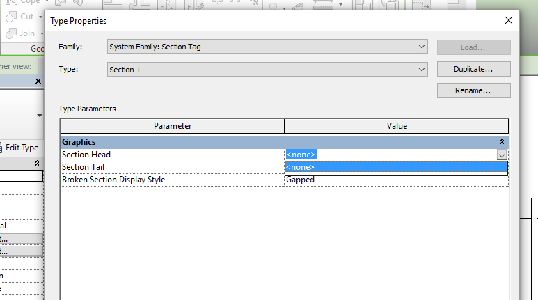

I have no section heads loaded into the project (see screenshot)

That just means that this type, "Section 1", has no head or tail assigned to it.   Arfe there other type?  Click on the type pulldown.  For the Section 1 type, you can click on either the head or tail pulldown to see your choices.

This is the only section type I have. There are no other head or tail options in the pull downs thats the problem. (did you see the screenshot?)

Figured it out. Go to the project of that has the section. Find the section head and tail in the Project Browser under Families - Annotation Symbols. Then right click and choose edit which will open the family, then you can load it into whatever project you want.
