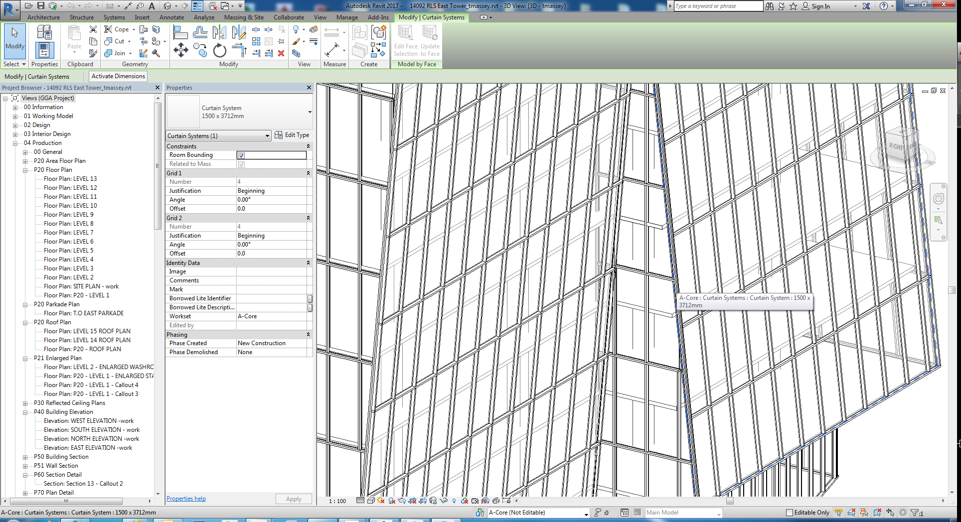

As per the attached sketch we have an exterior facade that is created with inplace mass curtain wall system for sloped glazing and curtain walls. We are trying to use the align tool to align the mullions between the two faces. We can select one gridline but not the other. What is the solution to aligning the grids at intersection or corner., Thank you.

Not sure if the actual 'align' tool is the answer. Tab to select the grid line then unpin it and either move it or change the temporary dimension. You may even want to place a dimension before hand if you know the delta movement required.

Thank you dgcad. As the building has 4 inplace mass faces with curtain systems. I need to keep the east and west exterior mullions fixed at 3700 and align the sloped curtain wall system mullions to suit. I might have to bite the bullet and just move each mullion on the masses one at a time.
