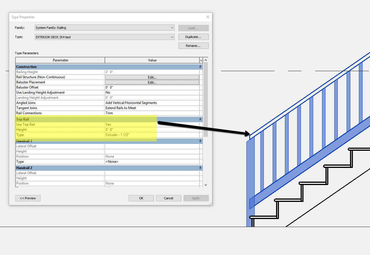

Can't get a residentail railing to end at the post as needed.  See attached pdf.  Need the hand rail to extend slightly past the post.
Thanks,
JK

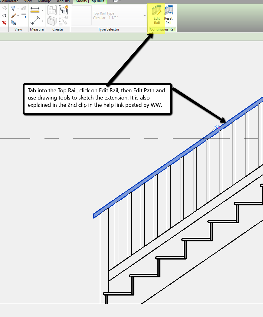

If just that top portion is the handrail, the handrail can be sketched to do that.  Another option is to use a handrail termination.
rail extension path
  1. Select the rail with the extension you wish to modify.
  2. On the Continuous Rail panel, click (Edit Rail).
  3. On the Tools panel, click (Edit Path).
  4. Optionally, display the Workplane Viewer and use the drawing tools to modify the extension path. See Define a Continuous Rail Extension.

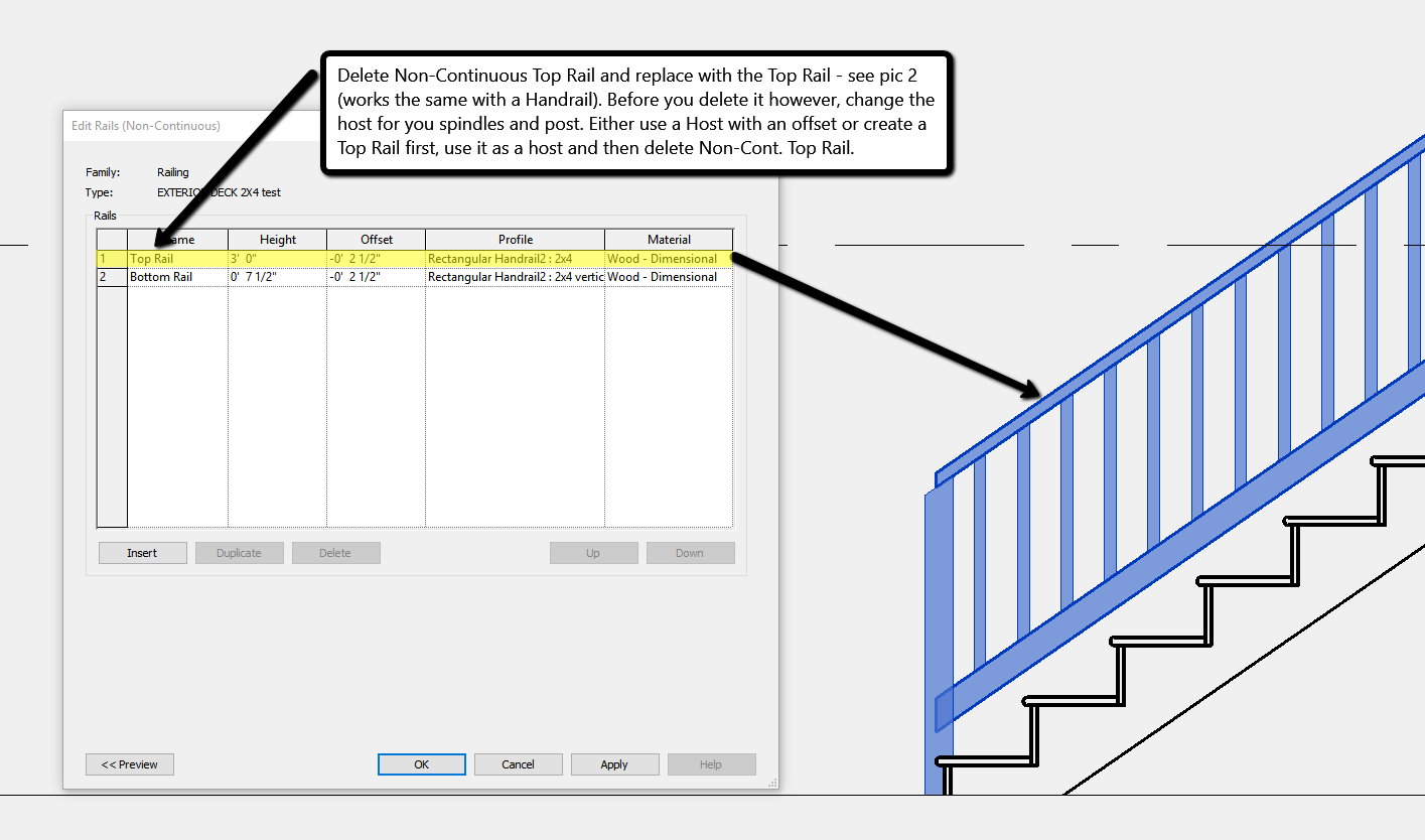

See pictures. I hope it works in 2017 LT as well.

Pijpiwo -  Thank so much for the help!  Your post bridged the gap, the screen shots were great.
Yes, it did work the same way with LT.
Cheers!
