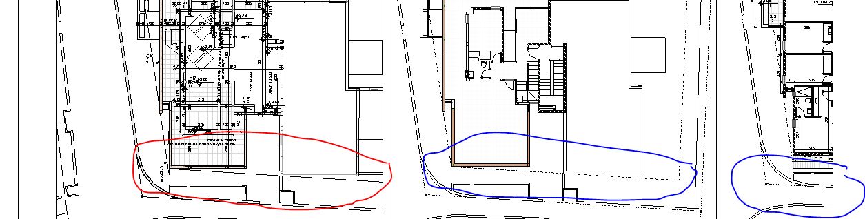

hello i've imported cad file into revit with some dashlines. Some plans display this line correctly and one plan display it as a continues line. if i apply a view template from the plans that the line is presented well on them, it fixes the problem. so - whats exacly do i need to change on visibility/graphics window?

My guess is the answer lies in the CAD file. Is it's linetype 'bylayer' etc . . .
