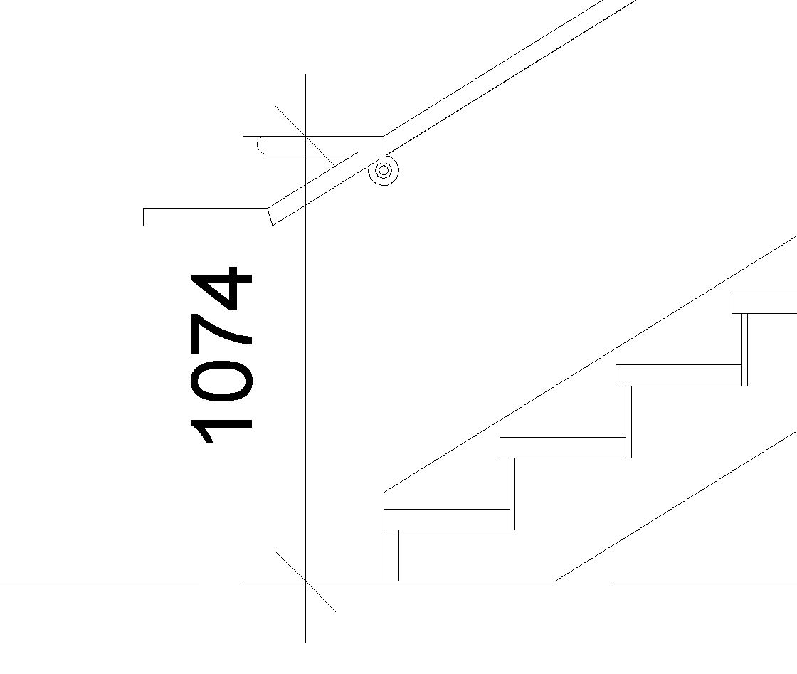

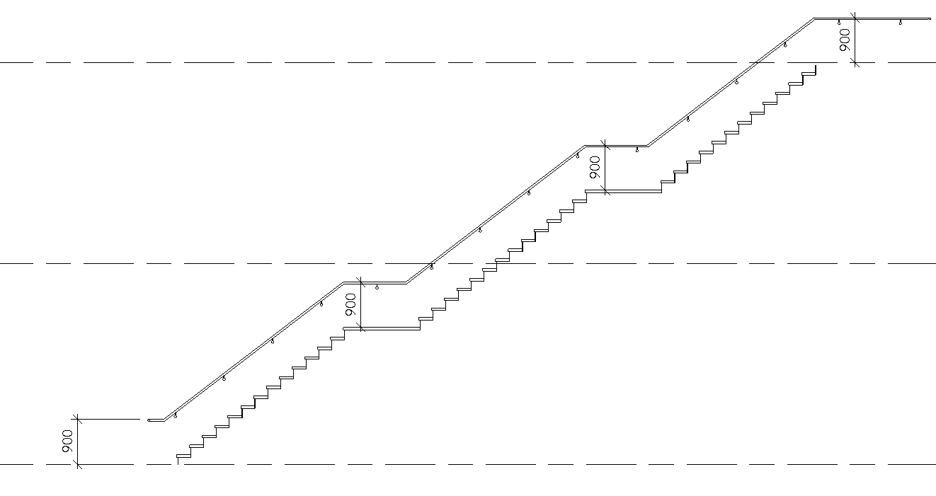

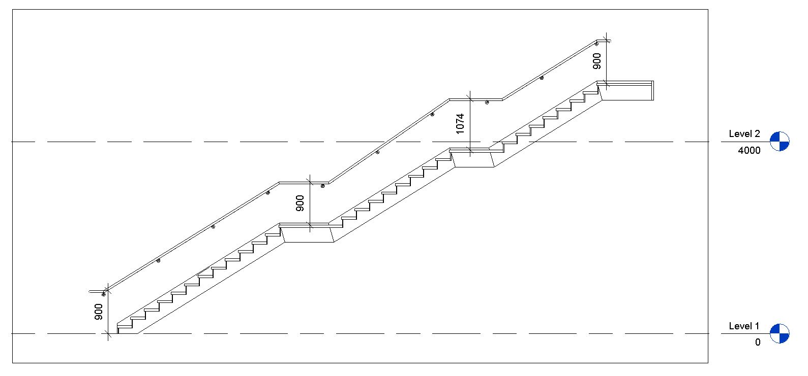

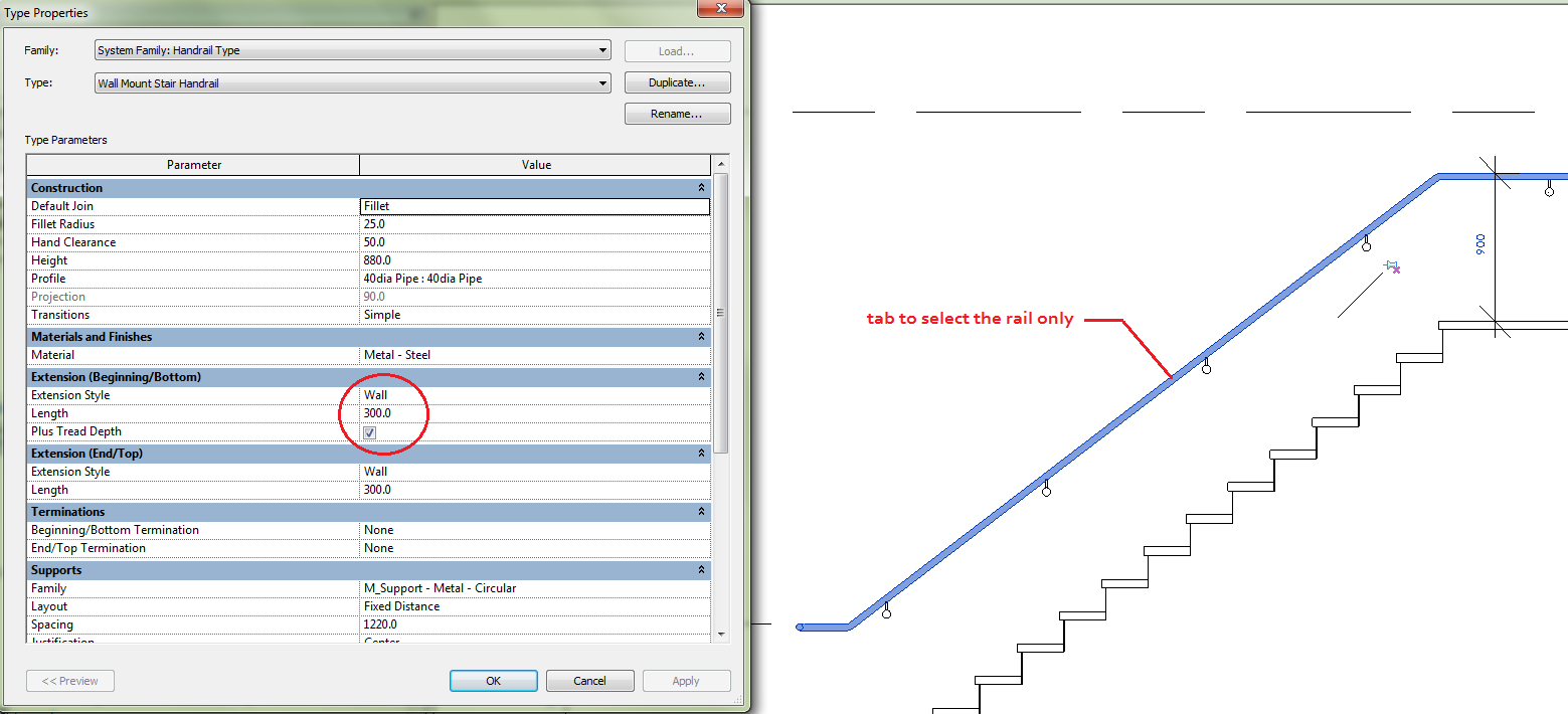

Hi, I am trying to get my handrail height to be at 900 throughout, as shown in default.jpg, you can see the bottom end stops at 1074. So in order to get the bottom of the rail to be at 900, I have to extend the rail out by 1 runs (280), as shown in capture1.jpg but the other flat railing at the other landing are not working. To fix that I tried extending the slope rail just like what I did with the bottom and I woud get that rail at 900 flat again like in capture2, however the handing from the first landing from the top is stuck at 1074. So I try to extend the sloped rail too for the top landing but it does not work at it, it looks like capture3 where the rail just detach from everything.

here are capture 2 and 3 jpg

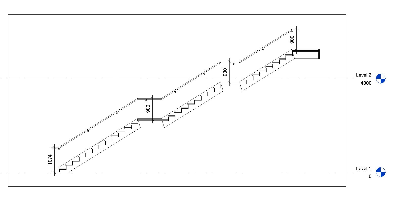

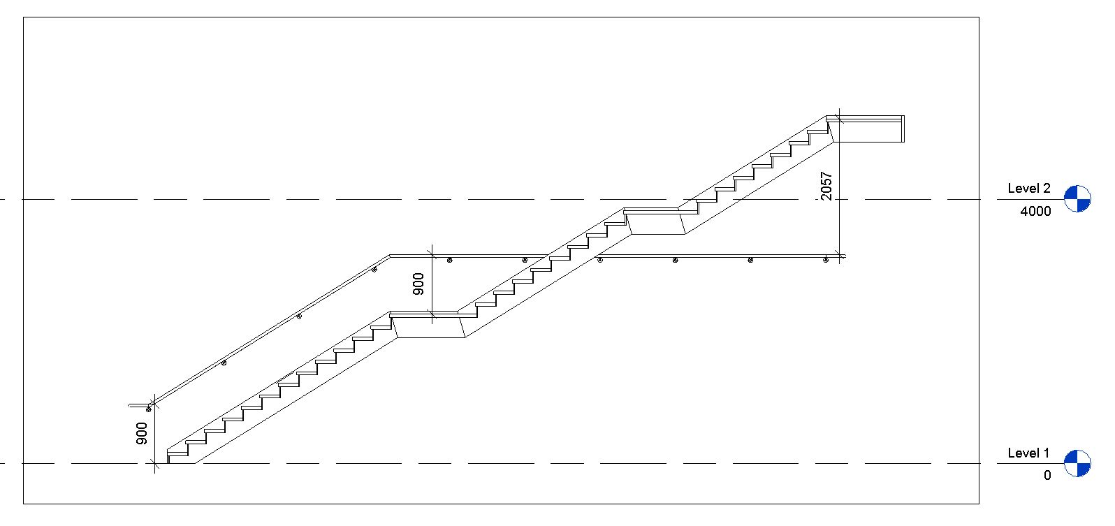

you shouldnt have to extend the rail at the bottom at all using the path. If you select the top rail by hovering over the top rail and hitting tab there is an option for bottom and top extensions where you can specify a distance to extend as well as to add the tread depth to it. See attached screenshots

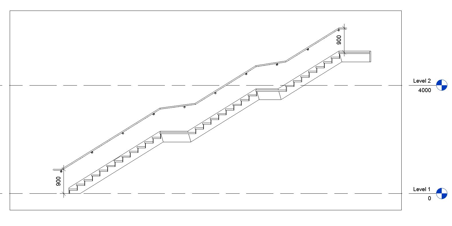

yeah I tried that, but the problem is it doesn't slope down, it just extend straight where the bottom rail ends so the height is still stuck at 1074 height.
edit: I redraw the handrail again, got it to work now thanks! How I have problem witht he extension, I think someone added their own extension to the rail profile, anyway to get the original replace with the one from revit?
edit2: I see its a baluster profile, so I removed it on both end. Does revit has a built in returning wall mounted rail?
