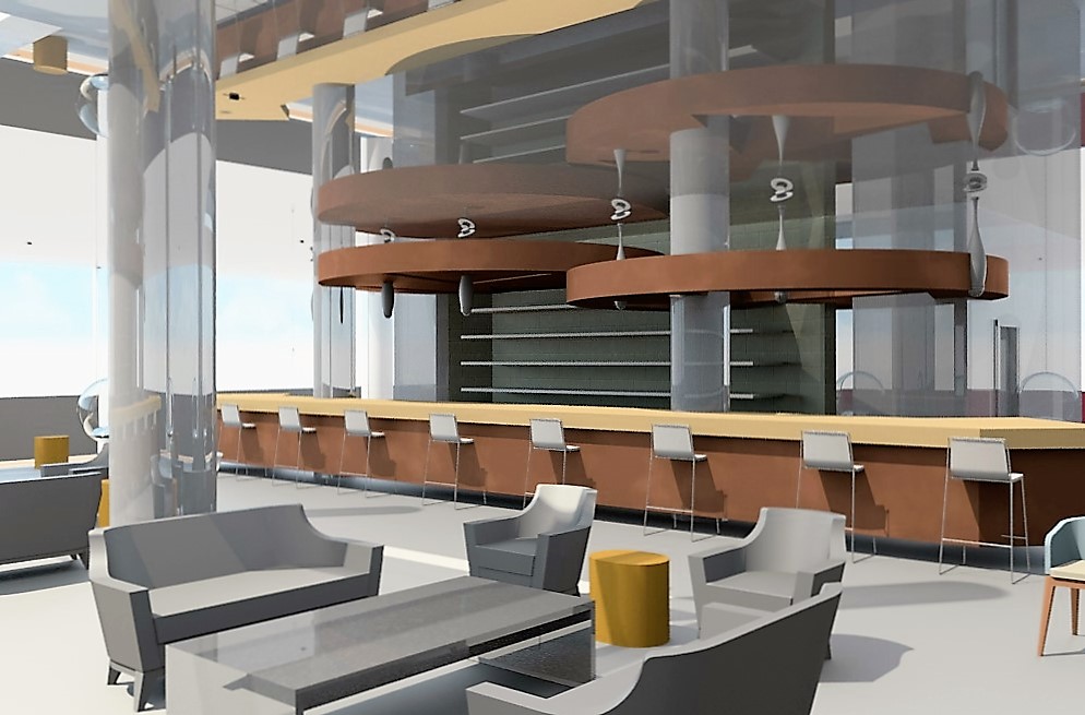

Hi, I am using REVIT 2015 (I am new to the program) and in my "realistic" view my walls, ceilings and columns are see through (wireframe almost). When I render they are very reflective. Like glass. I have checked my VG over and over and cant seem to figure out why this is happening. I feel like its something simple but i am stumped. I wil add a photo for reference. Thanks in advance

Material Asset? Shared, I suspect. Don't. Create a new one.
