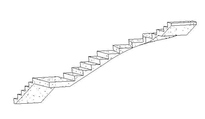

Hi there everybody.I am quiet new to Revit. There is probably something I don't understand exactly.I try to create a monolithic stairs and get the error: "can't create monolithic stairs".The result is at the attached image.
I'd appreciate any hints. Thank you much in advance. Best, ontaneas...

That's not a monolithic stair.  If you can't finish the stair, where did you get the image?
Your problem is your stair sketch.  Winder stairs are hard to do, especially for beginners.

At the create process the option is set to 'monolithic stairs'. Revit alerts an error at the end: 'Cant't create monolithic stairs'. Despite the error, the stair is created as presented at the attached image...

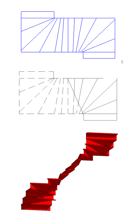

I think someone has changed the defaults here.  Look at my image and check your 'monolithic' properties.  Under construction, is the monolithic stais checked?  I doubt that it is looking at your images.   I don't know if that is what is causing some of your problem.  Monolithic stairs are really like cast solid concrete stairs and a winder stair will look more like my image.
Either way, the problem is how you sketched your stairs.   As I said, winders are hard to do and you need more tutorial work.
