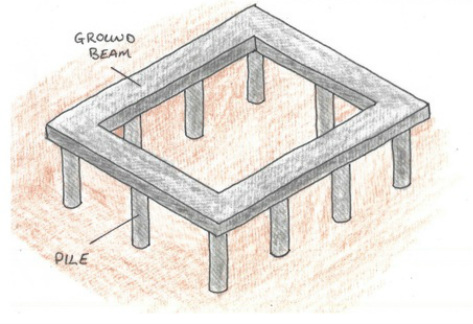

I uploaded a picture of what I want to model.
I have found a ways of modeling the gorund beam, using structural footing wall set in an underground level.
However, I have no idea on how to model piles beneath the ground beam. All pile families I have found are reduced to a cap with 2 piles only, whereas I want to be able to create a continuous and long linear pile array.
Please see picture attached.

Why not just use a round concrete column?
