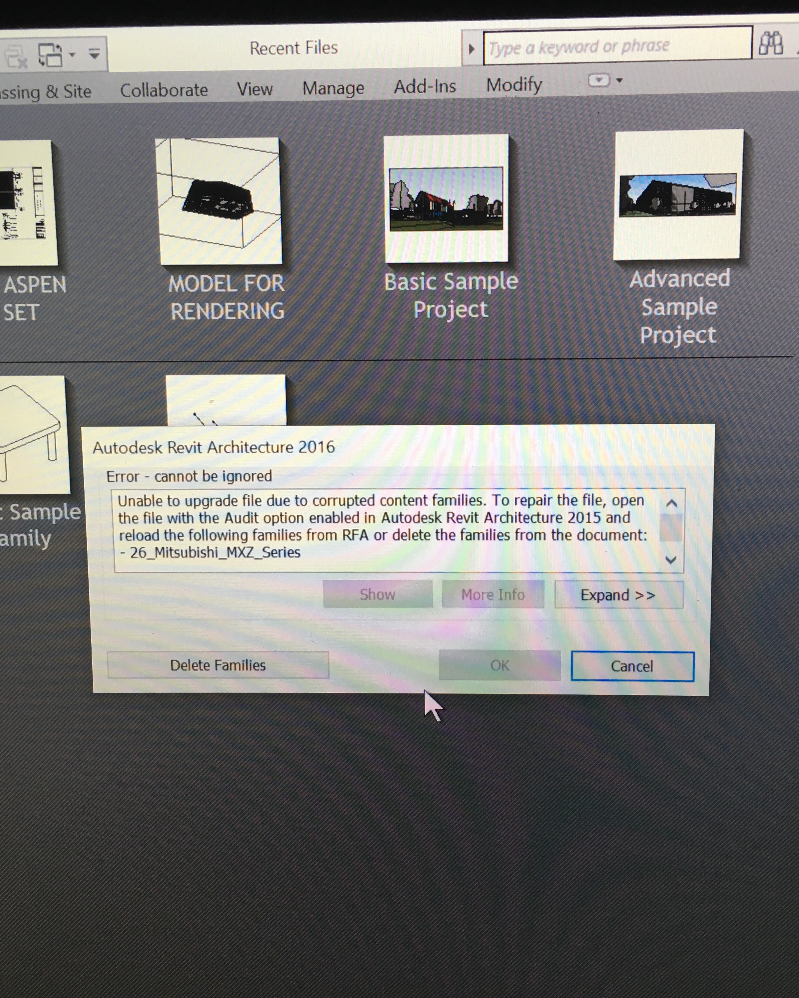

Hi All Im on revit 2015. Im trying to open a file and when it gets to 49% I get an "unrecoverable file..." error. None of the backup files work either. Tried all the "journal" fodler files and still cant get it to work.
I tried upgrading the file to Revit 2016 and I get the following message:
"unable to upgrade file due to corrupted families. to repair the file, open the file with the audit option enabled in autodesk revitarchitecture 2015 and reload the following families from RFA or delete the families from the document:-26_mitsubishi_MXZ_series-26_mitsubishi_SEZ_series"
How can I delete the families without opening the file (for revit 2015)? 2016 gives me a button to "delete families" but revit 2015 simply crashes
S.O.S!!

Within the open revit model window did you try ticking the audit option down the bottom as it suggested?If that does not work, within the open revit model window tick the audit option and detach option down the bottom.If that doesn't work some further options:If you are working in a collaborative model and have local files on your C Drive, go to the folder on the C drive where the local files are kept and either cut and paste them somewhere else ( so you can use them later if need be) or delete them all ( if you don't need them). Either way, empty the local folder of everything.
Try these for now.
__________I'm the guy they come to when they didn't follow my recommended workflows.__________
Thu, May 12, 2016 at 7:30:48 AM | REVIT 2015 DELETE FAMILIES FROM FILE BEFORE OPENING IT - UNRECOVERABLE ERROR
There is no reason to move or delete local files.
Are you opening a stad-alone, a local or a central file?
If it's a stand-alone and you can't open any back ups then something may bhe wrong with your system/program.  Try a different system.
If you are opening a local, try opening from the central.   If that doesn't work, then try opening that local detached.  If that doesn't work, then try opening the central.   If that too fails you could try a roll-back.  And if all fails and you are on subscription, send it to autodesk.
