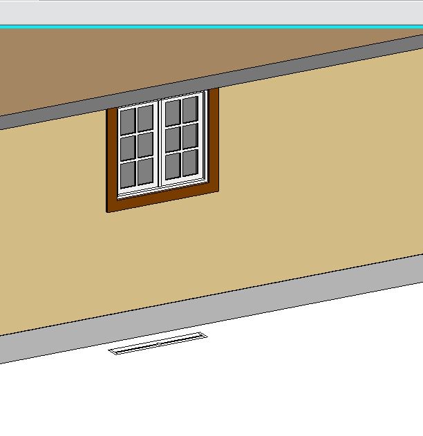

So CHeck th pic.
My symbolic lines for my window are way down on the floor plane. Do I need to open the family and rehost these to sit on the sill? I thought these were not model lines, but just lines in plan so you could hide the geometry of the window and have a cleaner graphic for the window operation etc...
Am I picking the wrong lines to draw?
Thanks in advance.
Michael

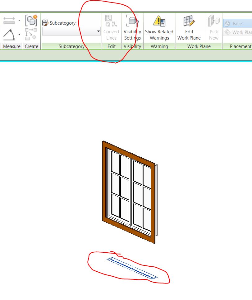

Thanks, seemed like a good simple fix. see pic. convert is greyed out.
Wed, May 11, 2016 at 7:48:08 AM | family symbol lines not in proper plane
How can you draw a 2D line in a 3D view?  You can't!   Pick them in the 3d then switch to 2d plan view then the switch will be available.

HAHA! that worked. didn't realize that was a thing but of course it makes sense.
