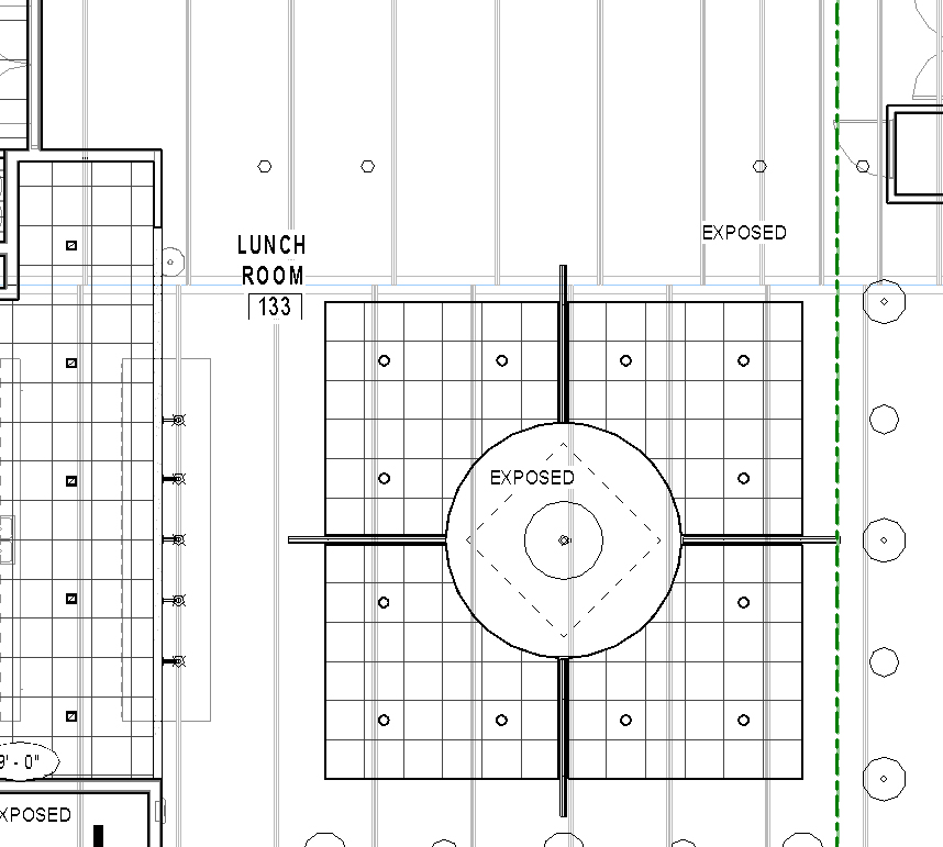

I have a linked structural drawing in my project that I need to show in the RCP.
It works great except for the fact that the structure shows right thru the ceiling as seen in the attached image.
Does anyone know a way to prevent this? I've tried everything that I can think of with no luck.
Thanks!
Fri, Apr 29, 2016 at 10:48:21 AM | Visibility woes - Structure shows through ceilings
I see a bunch of lines ... obvious ceiling but otherwise how are we supposed to know what is the structure and what isn't?  Communicate!
Is the structural modeled Revit or CAD?  You say drawing and that implies CAD.  No suggestions for this.
If a linked Revit, cut a section and look at where the structure is in relation to your ceiling.  What's wrong?
Hopefully your view is not wireframe or that you have an underlay on.
