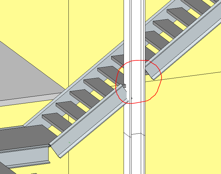

Hi,
I'm having a problem on how to have a nice connection between a sloped steel beam and a steel column. I was wondering if it is possble to make the ends of the beams highlighted in the attached photo, to be cut vertically?
Thanks in advance!

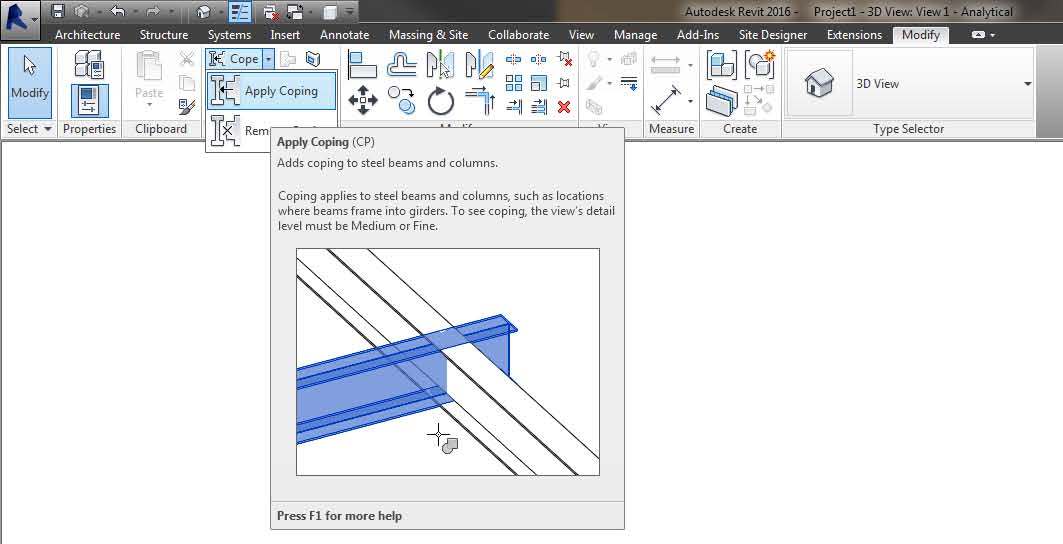

Use the coping tool.
Modify tab/Geometry/Cope
