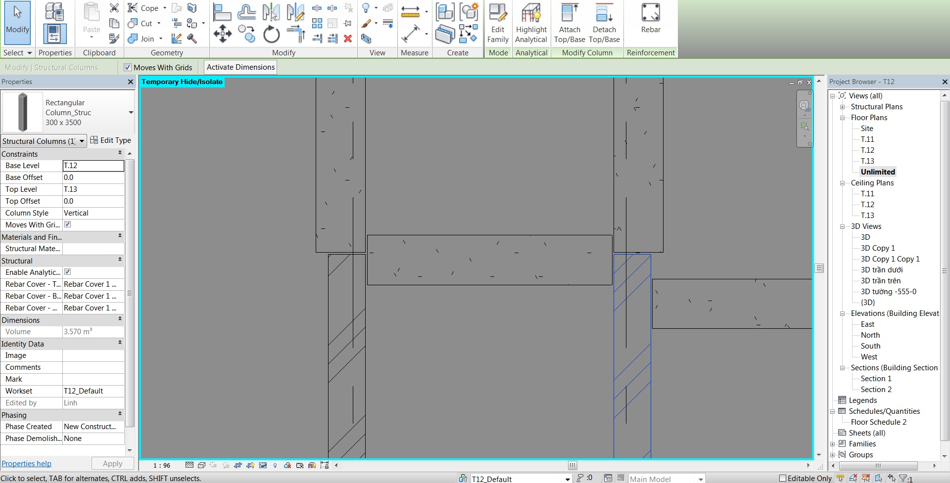

Hi everyone, i've just been using Revit for 2 months now. Maybe i've been stuck with this problem for that same amount of time. Here's the problem :
No matter what i try, Concrete Beams won't ever do what i want : intersect to the Structural Concrete Columns, or close-up to them. What they always always do is stop at the columns and offset from them with a consistent distance of 13mm.
The only way i could find out is "Disallow Join" every single Beam, and then move it to the specific spot i want, which i find very time-consuming.
I find that Architectural Columns would allow what i need, but then again i need Structural Concrete Columns instead. My boss don't allow me to paint Architectural Columns with Concrete material either Sad.
I would like to ask everyone around here if, there is any way to allow beams join close-up to structural columns, or intersect with them too ?
