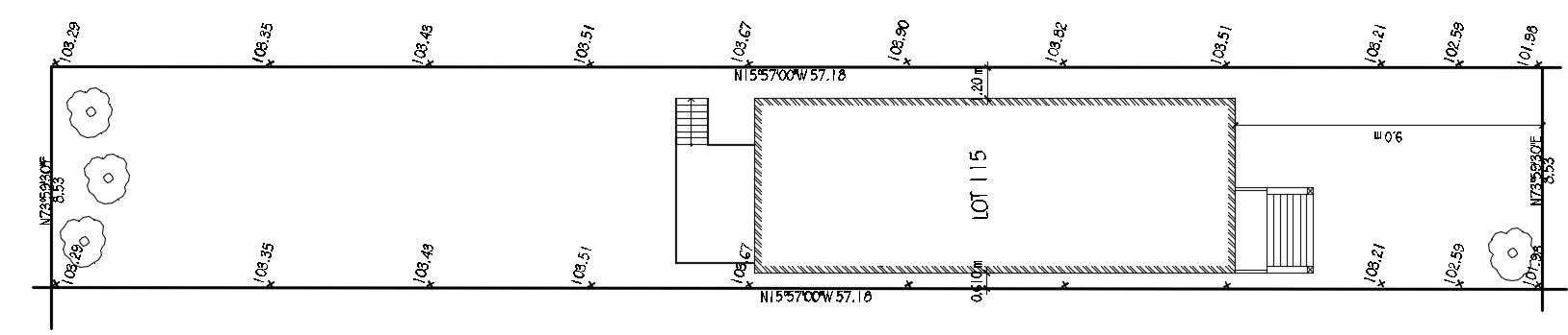

So I have this autocad site plan that I have to draw on Revit.

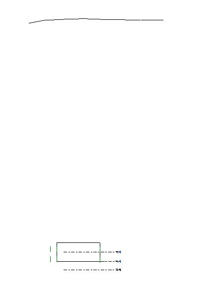

I drew the property lines, and created the topography revit with the exact dimensions as the autocad file. But when I look at the elevations, my levels are way below. How do I fix this. I tried playing with the Project Base Point elevation, but its not working. When I created my topo, I inserted the points, and changed the elevations to what the autocad file says. Am I doing it right?
How do I make GRADE level the same level as my topography.
Fri, Apr 22, 2016 at 8:56:59 AM | Newbies question about Revit
Simple way (but not always the best) is to goto an elevation view.   Dimension lock your levels.  Then either:
  • Change your base level reference from project to survey then change the elevation value on the level
  • Select the reference level and move it up the distance it needs to move.
