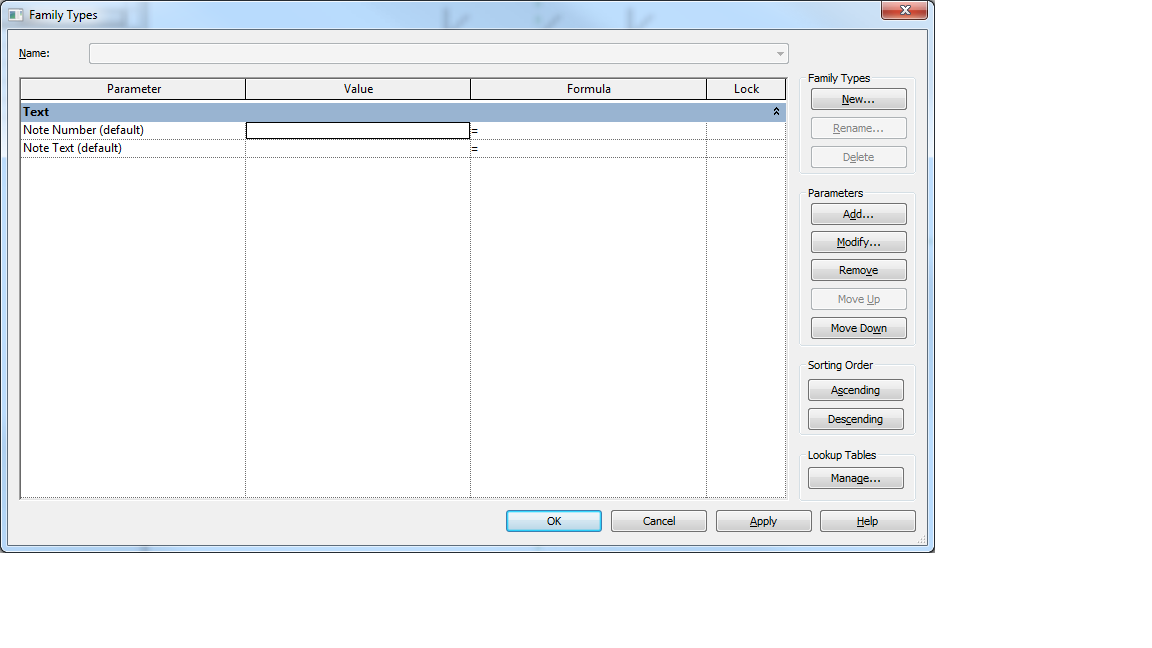

We have successfully created a demo annotative tag which populates our noteblock schedule. See attached. Any help on what the formula would be for the note number to read the note text in the parametere?
Right now it does however tag 001 is REMOVE EXISTING GLASS DOOR AND HARDWARE needs to be revised to tag 005 REMOVE EXISTING CANOPY AND STRUCTURE. We would like to revise the number in the tag and have the note automatically update.
What we want to achieve is editing the demo tag in plan and having the schedule populate. If the tag number revises the schedule updates.
See attached. And Thank you

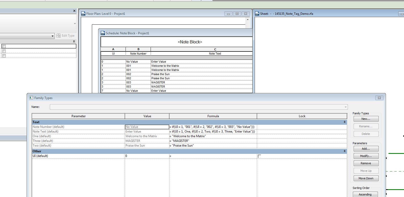

Not sure I'm following, but are you saying you want "Note Text" to change depending on what number is entered within "Note Number?"  You can do this with If formulas. Create an integer parameter; I called it 'UI'. Then create parameters (Text) and call them 'One', 'Two' etc. then within Text Note make an IF formula stating
if(UI = 1, One, if(UI = 2, Two, if(UI = 3, Three, "Enter Value")))
Within  Note Number repeat the above but replace parameter names with input, so:
if(UI = 1, "001", if(UI = 2, "002", if(UI = 3, "003", "No Value")))
That will allow you produce a output from a simple number, you can create as many options as you like. Whether this is the right way to go about this, pass. I just read your post and decided to see if i could find a workable solution.
In terms of the schedule, I would hide the "UI" and filter out the "No Values", but it depends on what you're trying to achieve.

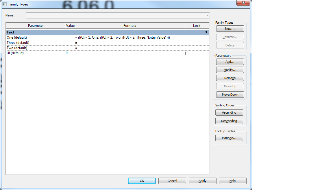

Ok I can't get the value to work. What the heck am I doing wrong. See attached
Fri, Apr 22, 2016 at 4:35:58 PM | Revit 2016 Annotative Demo Tag Formula
HermanMunster
Joined: Fri, Dec 13, 2013
0 Posts
5 Stars: 1 Votes
solved
if(Number = 1, "REMOVE EXISTING EXTERIOR CURTAIN WALL  SYSTEM ", if(Number = 2, " REMOVE EXISTING CONCRETE CURB", if(Number = 3, " REMOVE EXISTING CONCRETE BLOCK WALL IN ITS ENTIRETY ", if(Number = 4, " REMOVE EXISTING STUD WALL SYSTEM IN ITS ENTIRETY ", if(Number = 5, " REMOVE EXISTING INTERIOR PARTITION IN ITS ENTIRETY", if(Number = 6, " REMOVE EXISTING CONCRETE  WALL", if(Number = 7, " REMOVE EXISTING INTERIOR CLADDING STONE STAINLESS STEEL PLASTER ", if(Number = 8, " REMOVE EXISTING EXTERIOR CLADDING", if(Number = 9, " ALL EXISTING PRECAST PANELS ON COLUMNS TO BE REMOVED TO STRUCTURE INCLUDING INSULATION AND MEMBRANE.", if(Number = 10, " REMOVE EXISTING CONCRETE  WALL", if(Number = 11, " REMOVE EXISTING FACE BRICK IN ITS ENTIRETY ",if(Number = 12, " REMOVE EXISTING SIDING IN ITS ENTIRETY", if(Number = 13, " REMOVE EXISTING DOOR FRAME AND HARDWARE",  if(Number = 14, " REMOV REMOVE EXISTING DOOR ,SIDELIGHT,FRAME AND HARDWARE ", if(Number = 15, " REMOVE EXISTING OVERHEAD DOOR FRAME AND HARDWARE ", if(Number = 16, " REMOVE EXISTING GLASS DOOR AND HARDWARE ", if(Number = 17, " REMOVE  EXISTING REVOLVING DOOR AND HYDRAULIC ASSIST EQUIPMENT LOCATED IN THE PARKADE BELOW ", if(Number = 18, " REMOVE EXISTING DOOR STOPS",  if(Number = 19, " REMOVE EXISTING DOOR THRESHOLD AND INFILL AS REQUIRED",  if(Number = 20, " REMOVE EXISTING WINDOW, FRAME AND HARDWARE ", if(Number = 21, " REMOVE EXISTING GLAZING, FRAME AND HARDWARE ", if(Number = 11, " REMOVE EXISTING WINDOW COVERINGS",  if(Number = 22, " REMOVE EXISTING CANOPY AND STRUCTURE", if(Number = 23, " REMOVE EXISTING SOFFIT AND SUPPORT STRUCTURE ", if(Number = 24, " REMOVE EXISTING GUARDRAIL", if(Number = 25, "    REMOVE EXISTING HANDRAIL", if(Number = 26, " REMOVE EXISTING MEZZANINE AND STRUCURE ASSOCIATED",  if(Number = 27, " REMOVE EXISTING GATE,HARDWARE AND ENCLOSURE ", if(Number = 28, " REMOVE EXISTING FLOORING AND SETTING SYSTEM DOWN TO EXISTING CONCRETE SLAB. LEVEL EXISTING CONCRETE FLOOR SLAB TO ACCEPT INSTALLATION OF NEW  FLOOR FINISH", if(Number = 29, " REMOVE EXISTING STAIRS, HANDRAILS AND GUARDRAILS IN THEIR ENTIRETY", if(Number = 30, " REMOVE EXISTING STAIR AND HANDRAIL", if (Number = 31, " REMOVE EXISTING ESCALTOR AND ASSOCIATED EQUIPMENT. INFILL ESCALATOR PIT AS REQUIRED", if(Number = 32, " REMOVE EXISTING PARAPET IN ITS ENTIRETY", if(Number = 33, " REMOVE EXISTING PARAPET CAP ", if(Number = 34, " REMOVE EXISTING GARBAGE ENCLOSURE ", if(Number = 32, " REMOVE EXISTING GARBAGE BINS AND TURN OVER TO OWNER ", if(Number = 35, " REMOVE EXISTING ASPHALT PARKING AREA ", if(Number = 36, " REMOVE EXISTING WHEEL STOPS ", "End" ))))))))))))))))))))))))))))))))))))
