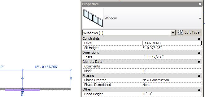

Dear experts,
please help me to figure out why i do see the window in the plan view of thr project?
Revit 2013.
Thanks.

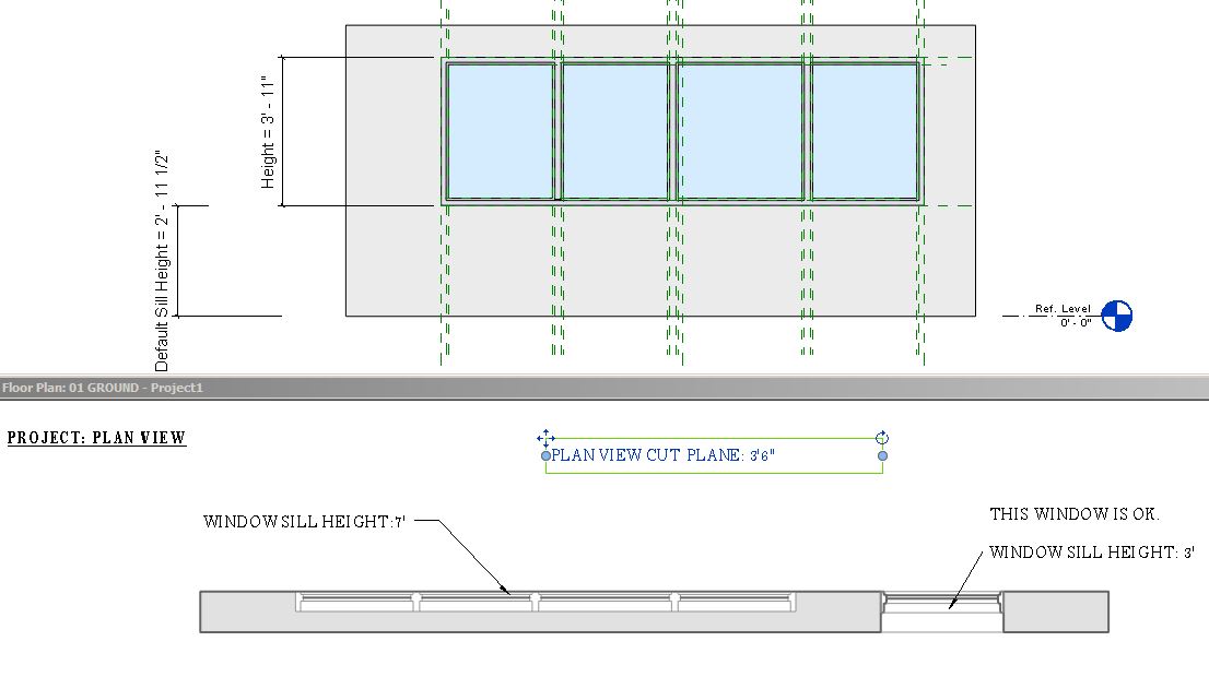

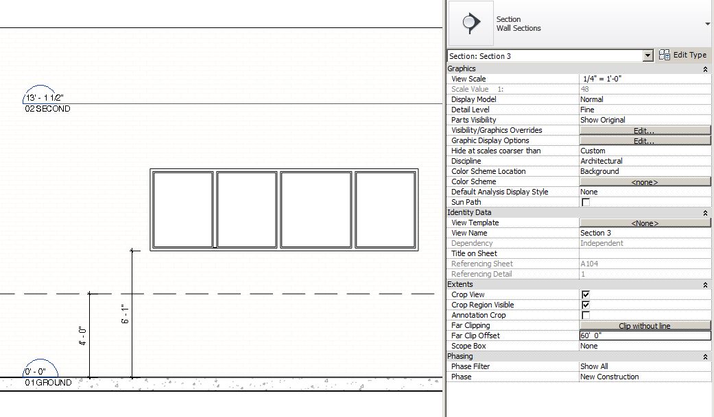

Mon, Apr 18, 2016 at 9:03:37 AM | Window Visibility in Plan View
No family was attached.
Mon, Apr 18, 2016 at 4:57:02 PM | Window Visibility in Plan View
#9
glenlake
Joined: Sun, Mar 11, 2012
25 Posts
3.5 Stars: 3 Votes
Thanks for the images. I still don't understand what's wrong.
Please see my view range.

Is that a stacked wall?
Tue, Apr 19, 2016 at 10:39:29 AM | Window Visibility in Plan View
#12
glenlake
25 Posts
3.5 Stars: 3 Votes
No, it is a simple wall. I tried this window in different projects, different wals. THe same story.
I could make another window, but i simply could repeat the mistake encrusted in that family.
Should i post the family again?
