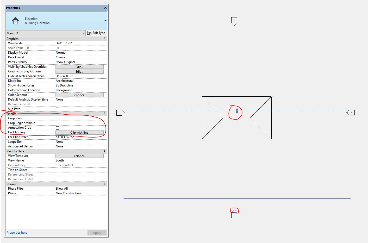

While in the elevation view in question on the view properties palette under Extents, make sure none of the boxes are checked and set Far Clipping to ‘no clip’.
Or better yet, in the plan view select elevation marker, set far clipping to clip with line or clip without line and adjust the clipping (depth of view) by dragging the blue arrows (see pic). The blue dashed line is a boundary of how far the elevation view is able to 'see'.

Not working. My Markers are away from my drawing. And I used the Clip with line thing, still not working.

I fixed it. Thanks a lot.
