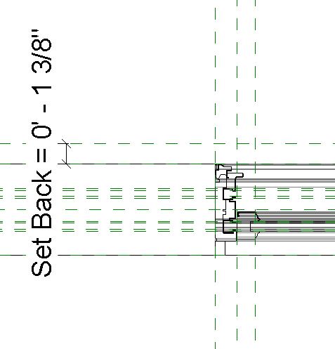

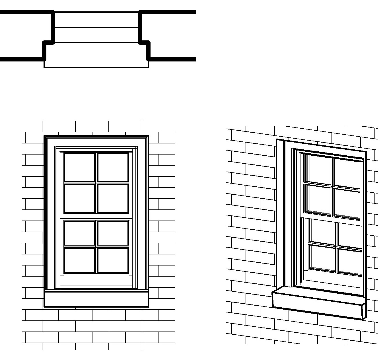

Attched is a window family based on Pella Architectual series famlily with Masonry opening, brick mould and Brick sill added.

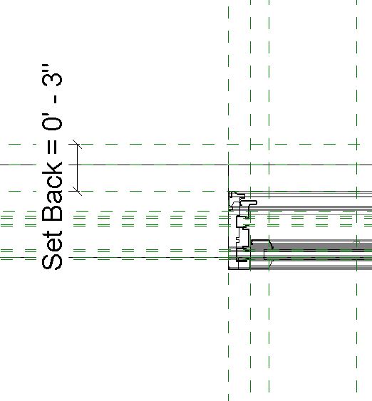

Once window is placed in the project (in a wall):  from the properties pallet edit the window type, you must change the Set Back to 5 5/16".  If you change the window size, you have to change the setback value.
This window family is working pretty nicely and showing the Masonry Opening as we need.  But, how do I get the family to have the 5 5/16" setback every time?      Since I started with the Pella family there are a lot of reference planes.  I can find the Set Back Plane (it is right on top of the MO depth ref plane).     But I can not get the Set Back ref. plane or the set back parameter to change.  When I try, I either get warnings about over constraining or nothing happens.
Any clues?    Any suggestions for improvment are appreciated.
Attached is jpg with window views, the family and the txt file for the sizes.

marmiketin1 - thanks for the reply but how to change a parameter in the project is not the question.      The question is how to get the setback to be desired value for each window type/size of that family?  The setback needs to be changed within the family but for changing the setbace in the family isn't allowed by revit.

You have messed with this file but it still works like the original.   I have opened both  the Pella file and your file and I have no problems changing the setback.
Notice that setback is from a plane 1 3/8 off the front wall face - not the front wall.
