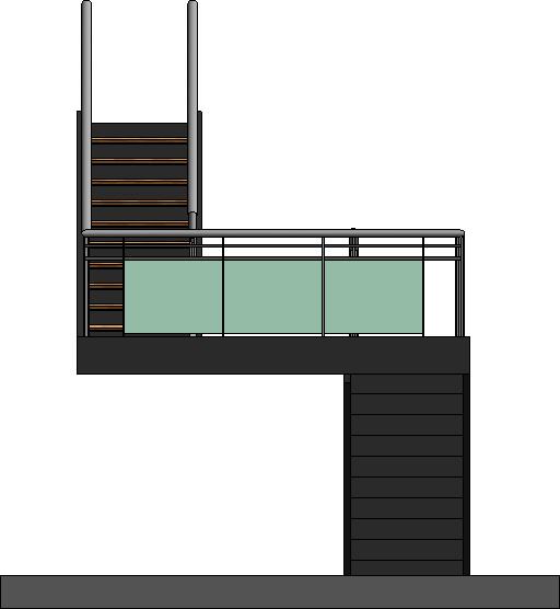

Hi, I'm trying to view a section through a set of stairs by component, to see the joints of the glass panels to the raisers/railing
Does anyone know how to do this? I did view section right through but it doesn't show the joints and stuff

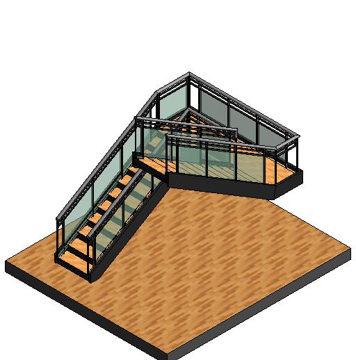

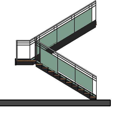

This is what I modeled sorry for not being clear

So where is the section that you want to show these joints?  I doubt that you can cut it at a tread because the bottom will be sloping....I can't tell what you are doing since some panels end above the stringer and some don't.
Don't count on everything being modeled.  You will probably have to add detail components.
