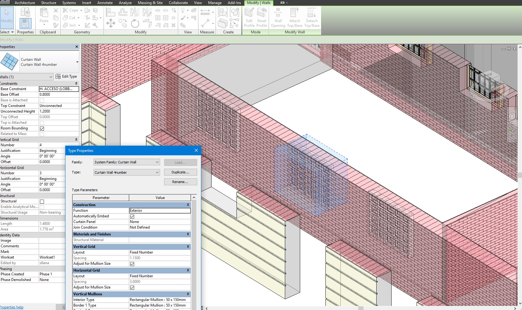

Hi, me again, in revit 2016, what could be the cause of a curtain wall is not cutting the host wall ?(as shown, the "automatically embed" is checked) and it is happening only in one wall with the same type of curtain w. than the ones that do work.
Any comment wil be apreciate.

There is no such thing as host wall for curtain walls. You are asking about a curtain wall and a normal wall in the same location.
One possible cause is design options.  Are you using those?
Pick that CW and recheck your automatically embed on that CW.  Don't assume it is the same CW.
Although these walls apear to be in the same plane, I don't know that for sure because I don't have a plan.  Too many students only work in 3D views and items may not be where you think they are.

Thank u. Yes, was that. A sligth diference beteewn project north and the view orientation.
