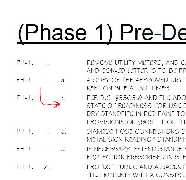

Only issue is, I havent been able yet, to indent any of the sub-text (See attachement)
1.  Text text text
    1.b. Text text text
Does anyone have any idea on how to get around this issue? It is very useful for me to have it in a keyed schedule since I have over 150 unqique sequence steps and I can just use keynote tag on the plan, section and detail views corresponding to the procedure.

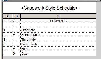

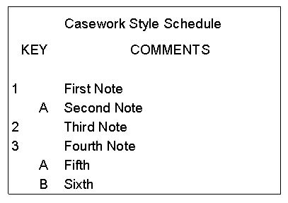

I really prefer true keynotes - That being - here is what I came up with.

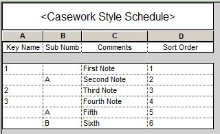

  1. Schedule on sheet
  2. Starting schedule - not added columns.   Sort by sort column.
  3. Modified schedule - hid sort column - combined headers across first 2 columns and changed their names to <blank> then did the same with last two columns so that Key and Comments were on same line.
