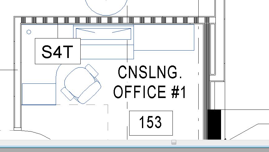

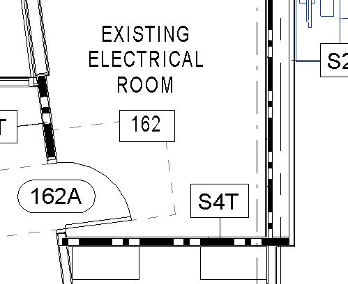

In Revit 2016, I have wall types that are made for smoke/sound and fire rated partitions. For some reason, the fire rated partition graphics are properly rotating with the wall type, however, the sound partition grpahic will not. All of the graphic patterns are drafting type patterns. I don't know what other settings to check.
See below for the differences between the two. How can I get the smoke/sound graphic to rotate properly?

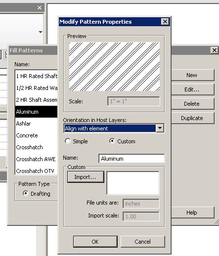

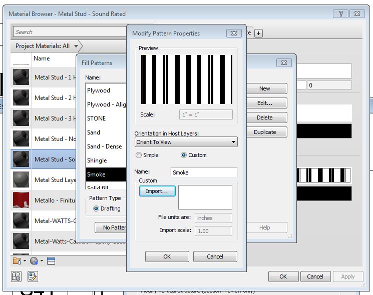

What are these "graphics" ?  I guess they are a material or a coarse fill pattern assignment?
Look at your fill patter settigs as I show.

That did it. Excellent catch. Thank you.
