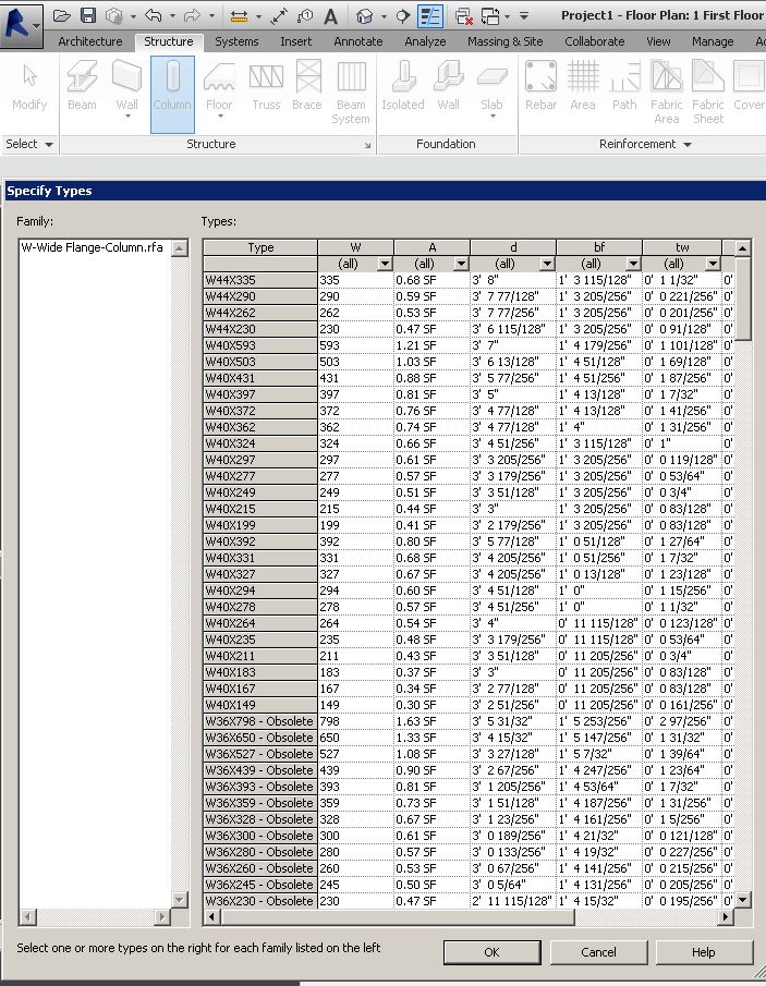

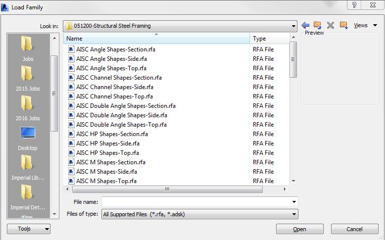

I have several pages of steel columns in my stock library.   See image

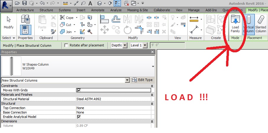

You don't seem to be using the correct process.  Pick structural column in your project then load, then pick structural columns in the library, then column type - etc.

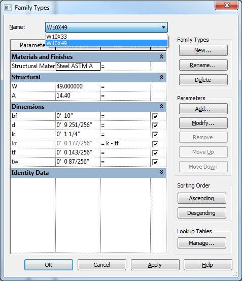

The attached pic shows that I only have 2 types loaded in the project.

Please do as I have posted ....   YOU HAVE TO LOAD MORE!
Fri, Mar 25, 2016 at 8:30:21 AM | Actual Columns with proper sizing?? Where do I get these?
You have to pay attention to your menu options.
