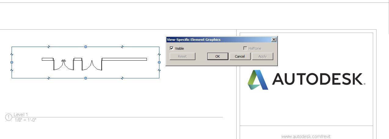

Thanks. I think i did it by overriding the thing in view. Fail.
Fri, Mar 25, 2016 at 9:23:00 AM | Crop Region Line Control
Johnzo142,
You should always test your answer first.  I tested that before I answered and you can not override element for crop region lines.
Fri, Mar 25, 2016 at 9:45:23 AM | Crop Region Line Control
Johnzo142
Joined: Fri, May 8, 2009
47 Posts
I did test it before my answer and it most certainly does work. I even printed my test prior to answering to ensure that the color came through. I'm not in the office at the moment or would post a screen shot.
Fri, Mar 25, 2016 at 9:55:15 AM | Crop Region Line Control
#9
Here is my image
Fri, Mar 25, 2016 at 9:58:13 AM | Crop Region Line Control
#10
Johnzo142
47 Posts
Strange, that's not what I got. I did it from an active view on a sheet, perhaps there is where the difference is.
Edit: Nevermind, I see from your image that you are in an active view on a sheet. I'll post my image later.

Mon, Mar 28, 2016 at 9:21:25 AM | Crop Region Line Control
#12
Johnzo142
47 Posts
Just to follow up, it appears that the override by element feature is not available for a plan view but is available for section and detail and elevation views. WWHub, this is where the difference was. glenlake, you are correct that there is no way to control this globally.

Mon, Mar 28, 2016 at 12:35:40 PM | Crop Region Line Control
#13
Johnzo142,
I have to apologize, I was just being stupid.  I think I had used the crop region over-ride several years ago and had forgotten because we turn off crop regions when printing in our office.  When I checked it for plans, it was not available and I failed to check it for sections and elevations.   Revit has changed so much over the years and I did not follow my own advice.
