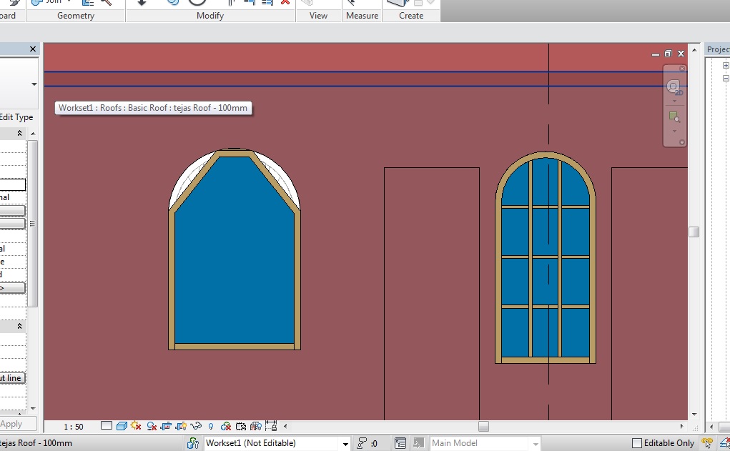

Hi everyone, i have a problem (revit 2016) im doing curtain walls, by editing profile, with an arc, and sometimes the arc mullion it is done correctly but some times revit can not do it, as shownin attach, can anyone figured it out why?
And the error msg says that the portion of the grid no longer exists.
C'mon guys. Mr WWhub, Mr. Typhone, what are your theories?

Does the curtainwall family you're working with have any predefined vertical or horizontal spacing parameters? Also, does the curtainwall adjust for mullion size? Those can break it for sure depending on how it interacts the the curtain panel (which in your case would have to be a system panel to use the mullions).

Yes, and thank you, "adjust for mullion size" is checked. I passed through that, editing good ones, and never knew why that happened.
