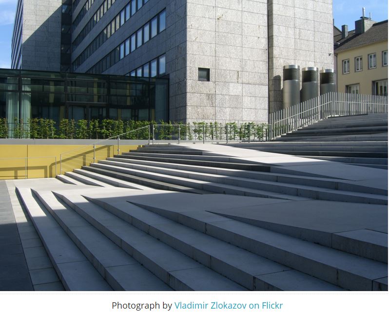

Hey all,
Was curious if anyone could suggest the easiest way to accomplish this stair/ramp combination (see attached). My only thinking right now is to do a mass, but that seems like it could take a while. Especially if the design of the spaces changes.
Lemme know whatchya think.

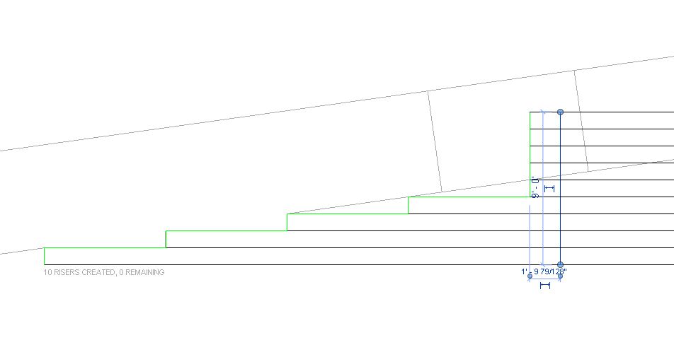

Tue, Mar 22, 2016 at 8:01:26 AM | Stair/Ramp
This is really pretty simple.
  1. Lay out your base ramp.
  2. Ly out a set of stairs wide enough to intersect the ramp.
  3. Now edit the stair sketch to make each tread end at the nose intersectio of the riser to the tread above and the ramp.
  4. Then edit the ramp edge to describe each tread slope area.   See attached.
