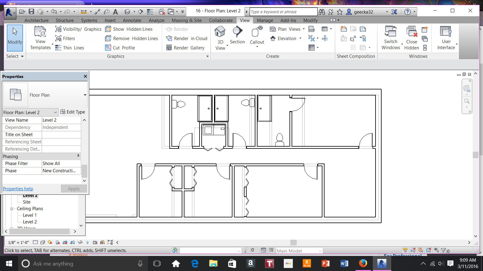

Hi,
Im a student learning Revit. I am doing a simple floor plan currently. When I move walls the original wall location is still
there as a light gray line. I can not delete it. It wont highlight to change it. However, when I place componets that line shows
up as a guide. My floor plan looks horrible. HELP!

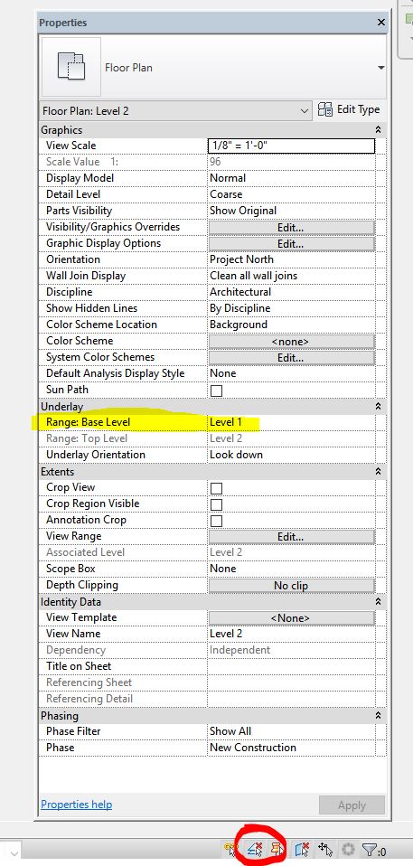

Set underlay to none.
It’s not selectable because ‘select underlay elements’ option is disabled.

THANK YOU THANK YOU THANK YOU!!!! you saved my project.
