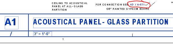

When I place a "view reference" in a detail, the referenced view does not obtain "reference sheet" and "referencing details" in its properties. Callouts, sections, etc., seem to work fine from what I've found.  When those views are referenced in another view, the "reference sheet" and "referencing details" properties are filled in. However if only a "view reference" is placed those properties remain empty.  Has anyone found a workaround for this or have some suggestion on if I'm doing something wrong?
See attached image for clarification

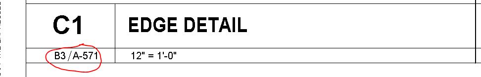

Thanks for your response, We are having the issue with views that are placed on sheets.  See attached images for more reference.

Sorry for the confusion. Yes it is a View Title that is set up to back reference.  The images were showing that the view is placed on a sheet, and that the view is being referenced through a view reference in another detail, but the back reference is not being updated.
