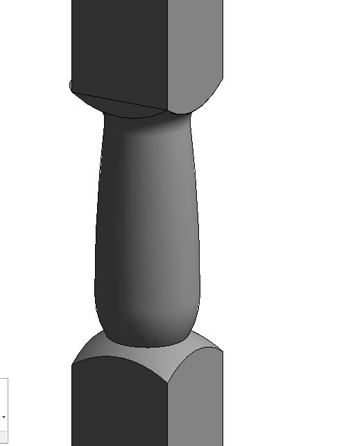

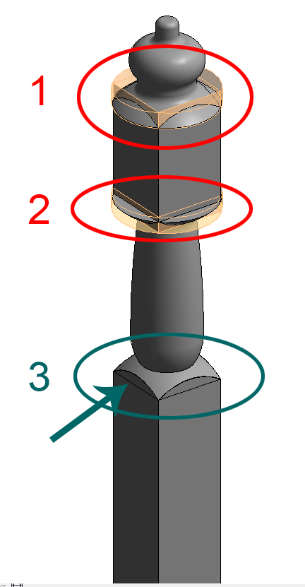

Hello everyone,I need your help and teach me how to do it.I create post for single bed. Please see the picture I create old shape post for single bed.1. Top: Revolve and add void forms to cut around it but not successful, see orange void.2. Second from top: Extrusion, it is easy to create Extrusion but I don't know how to remove the line after it merges with revolve (include void forms), See example 3. If I did it, Revit says, "Can't keep elemens jointed". :-/ I hope you understand with my English otherwise have a look it at *.rfa (2016) to open and see there.Many thanks,Bogumil

The lines are because the faces are not aligned I aligned one side and the line goes away.
This is really too complicated.  Why not one simple vertical square extrusion with two void revolves?Look at what I did with your middlw upper void.  One rectangular void copied around.  This fixes the "can not join" issue.  << But you don't need this if you do a revolve void.

That file is not corrupted - I just saved it to my system and opened it to check it.  You have to right click on it and do a save as.
But you really don't need that file.  Do as I suggested, a vertical extrusion with a void revolve.
