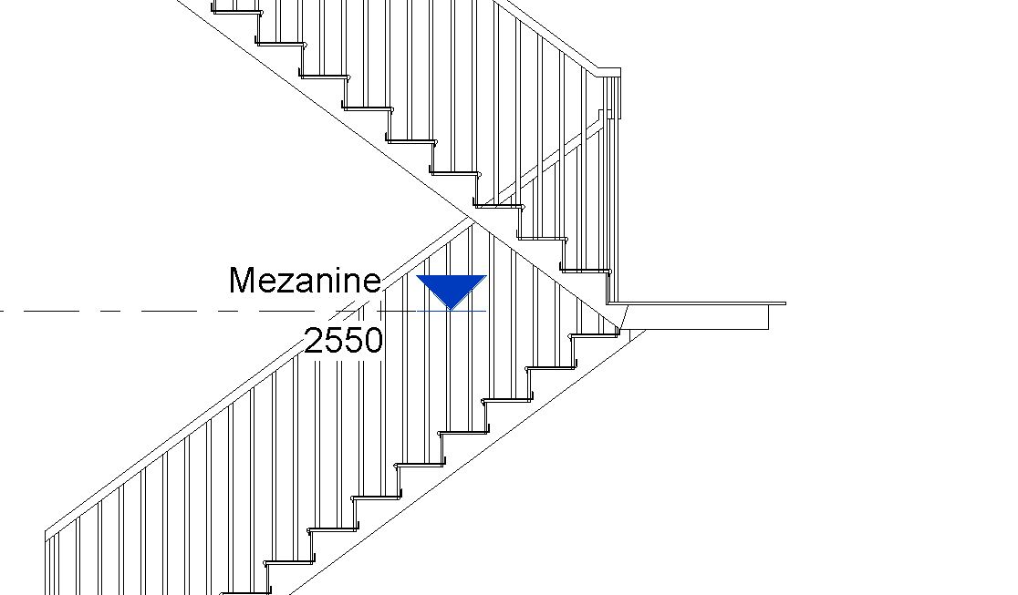

Hi I am using Revit LT 2016. I am trying to put a staircase in my building but when I add the landing it doesnt sit at the right level.I drew a staircase outside of the building to show you what I mean and have attached a screen shot. Has anyone found this issue and know how to correct it?
Its only out by a couple of mm but its making this project really difficult
Mon, Mar 7, 2016 at 7:40:02 AM | Staircase not going to levels?
Revit is only doing what you tell it to do.  If you create the stairs and tell it equal risers (as you should), then the landing height will be set by that.   If you must hit a unique landing, then your risers may not be equal and you will ahve to do that in two seperate stairs.

Thanks WWHub,Your right that does work better, thankyou for that!
