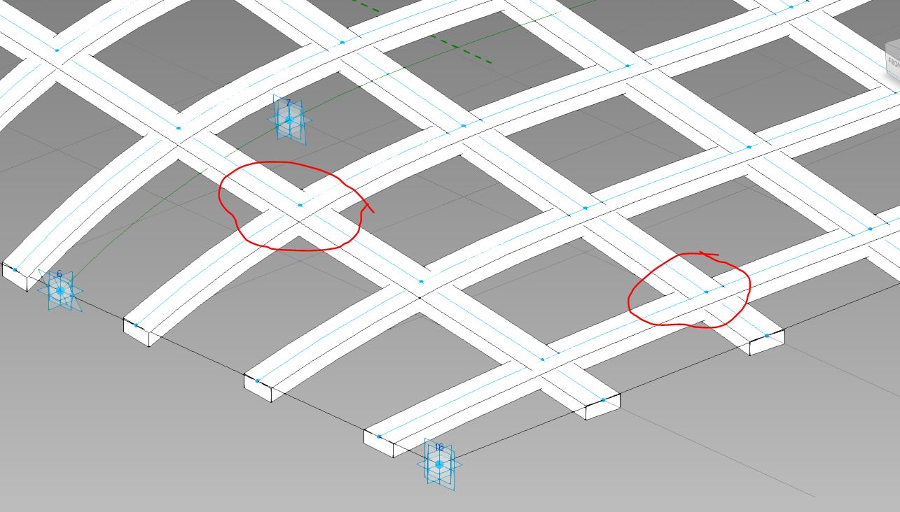

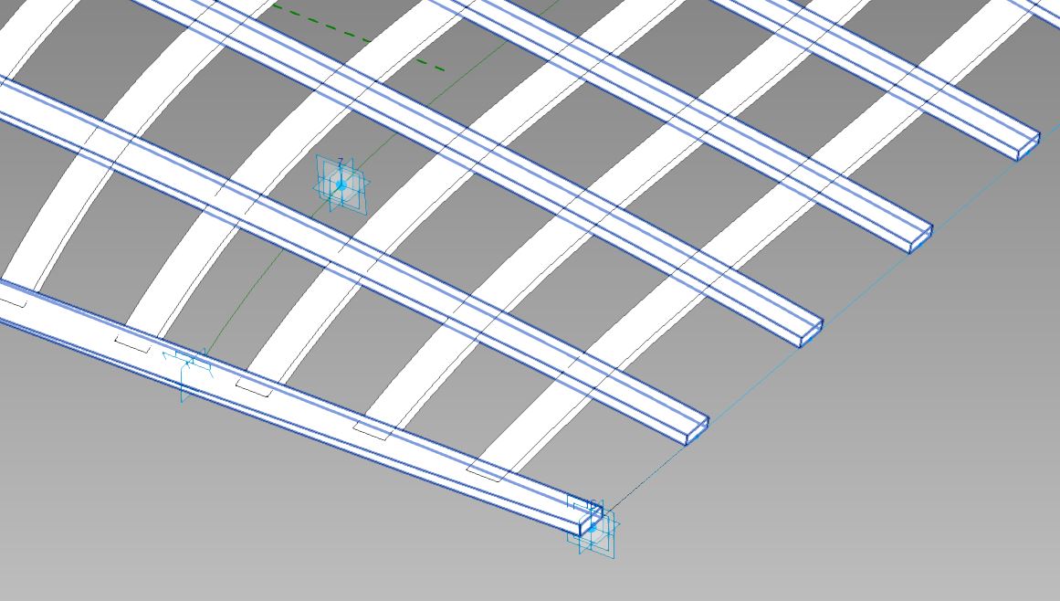

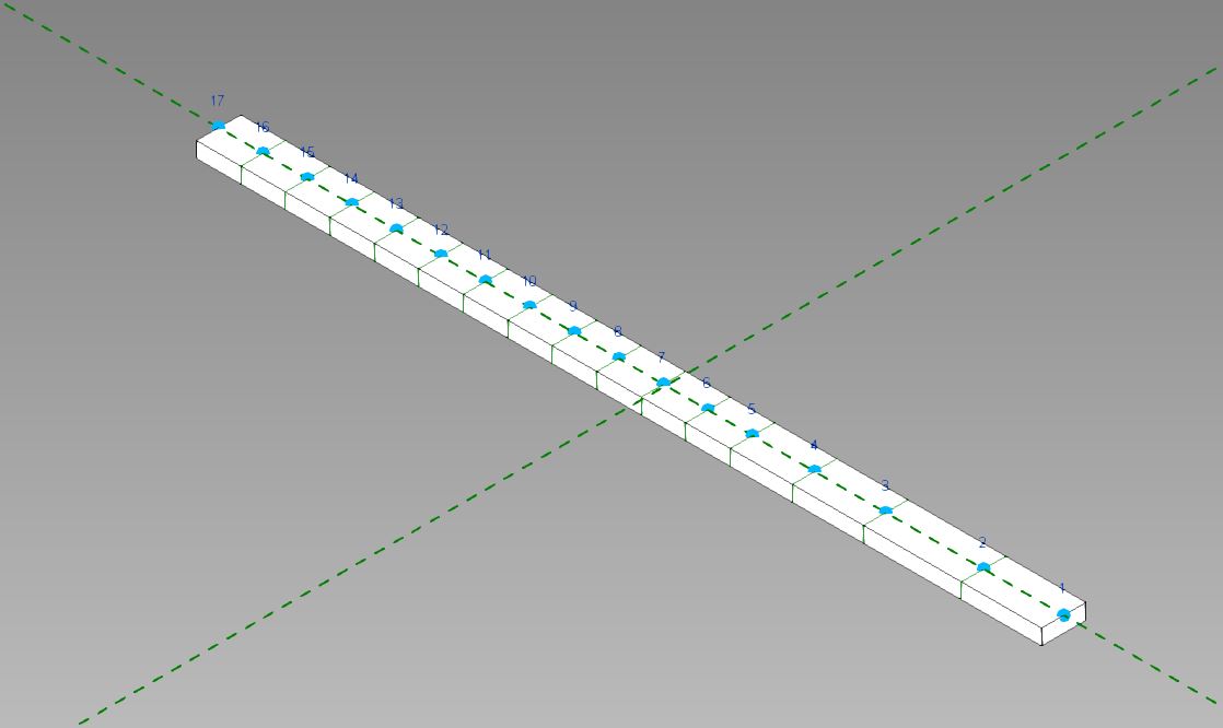

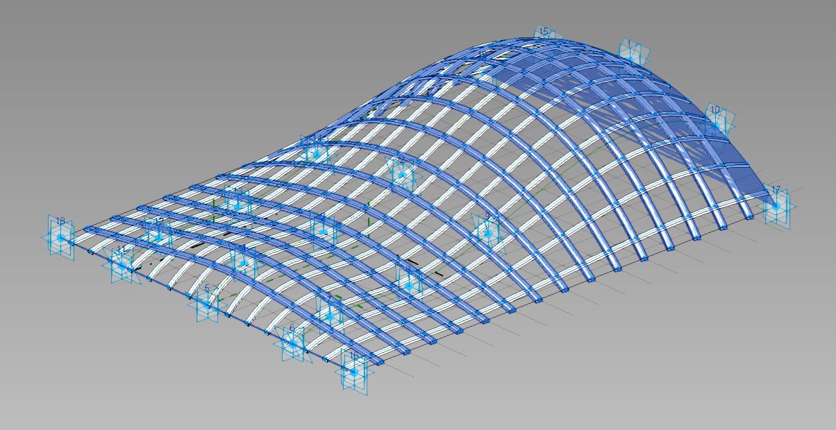

I'm trying to create intersecting ribs in a semi-spherical shape that has multiple curves. The mass itself was a success , the ribs i made of adaptive components , but instead of repeating them per spacing , i repeated them along the entire structure (see the pictures). Now the problem is that the ribs do not intersect perpendecularly to the ribs from the other direction (see the picture). Is there anyway i can make them perfectly intersect ? Moreover, is there a better workaround to create the mesh ?? thanks alot.

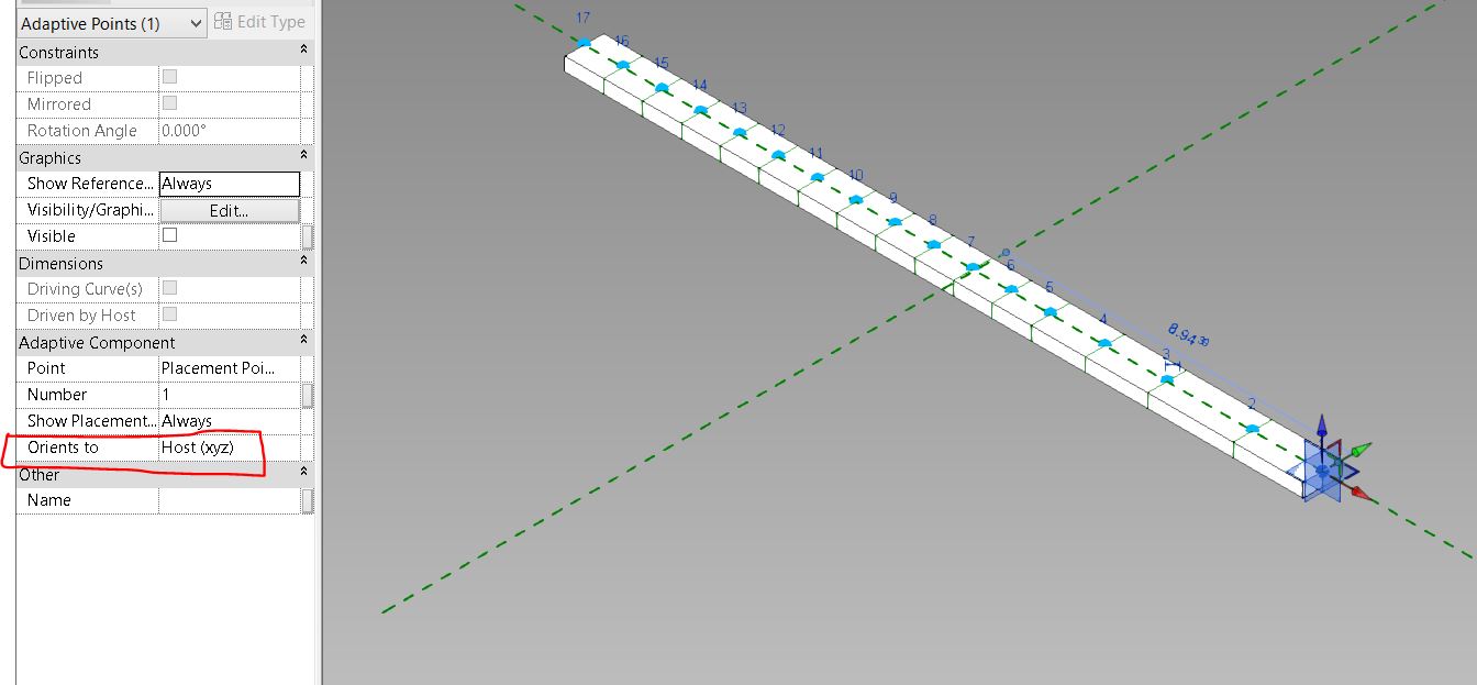

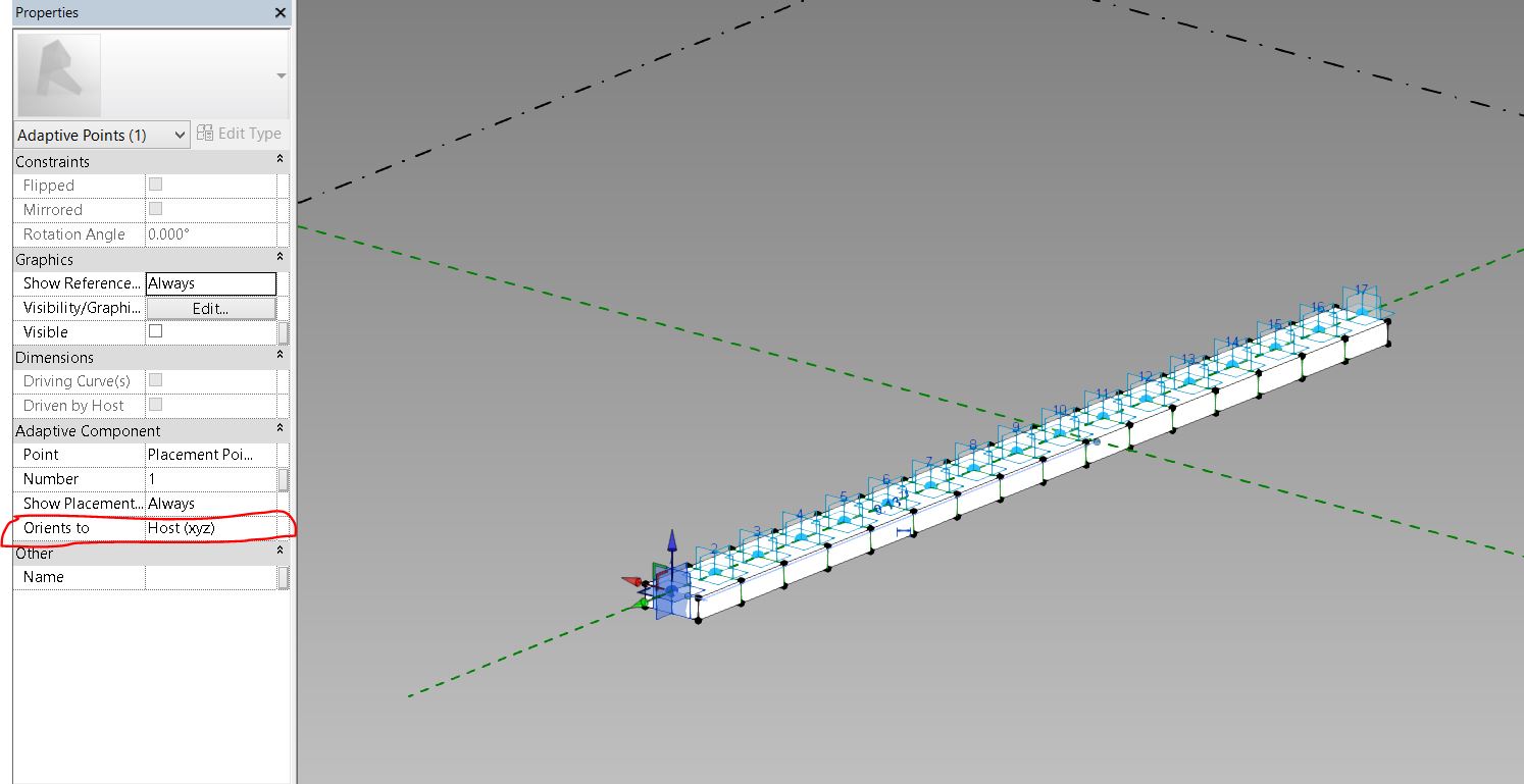

It Turns Out I had To Check The Orientation of the Adaptive Components , I Created Two Different Adaptive Components , One For Each Direction; So Basically The Same Family But One Of them Is Right-angle Rotated.

It Turns Out I Had To Check The Orientation Of The Component. Plus, I Created Two Families Of The Same Family And Rotated One Of Them For The Other Direction.
