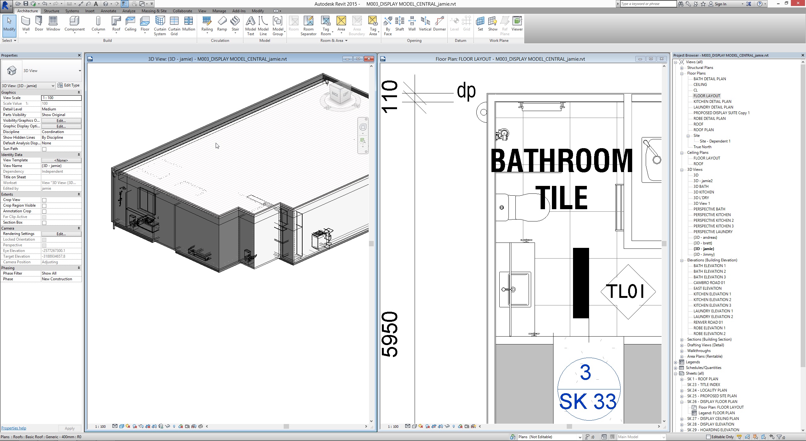

Hey guys this is driving me nuts...
The walls and roof are transparent for some reason.
I have checked finishes they are not transparent or glass
I have checked graphics overrides... nothing
Use accelerator is checked on in settings.
Discipline is on Coordination or architectural still the same.
Any other ideas? Thanks heaps.
Revit 2018........

worked it out... for anyone who wants to know.
We had a large cad file imported into the revit file which made the walls transparent... dont know why.
