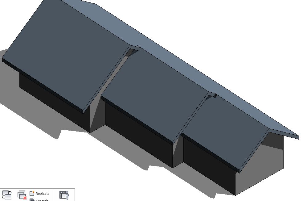

Mon, Feb 29, 2016 at 11:24:33 AM | How to create a gable roof with sloped eaves
Here is my test.... you have to play around with the one wall where I show my cut.  That wall will not attached to roof so I had to sketch it.

Mon, Feb 29, 2016 at 1:42:04 PM | How to create a gable roof with sloped eaves
sorry - I did not see that question from what you gave us.
Do that roof as a seperate element and knotch the side of the other roof sketch after you define this roof.  Use a slope arrow instead of slope defining edges.
BTW - you should still look at my first answer to help you with the other roof.

Mon, Feb 29, 2016 at 2:55:36 PM | How to create a gable roof with sloped eaves
Please re-read my previous post.  SEE SLOPE ARROW... Look at the sketch - the slope area goes from corner to corner on this roof by footprint.   (Sorry that you can't see the slope arrow on that roof sketch but that is what defines the slope and it looks like a centerline.)
