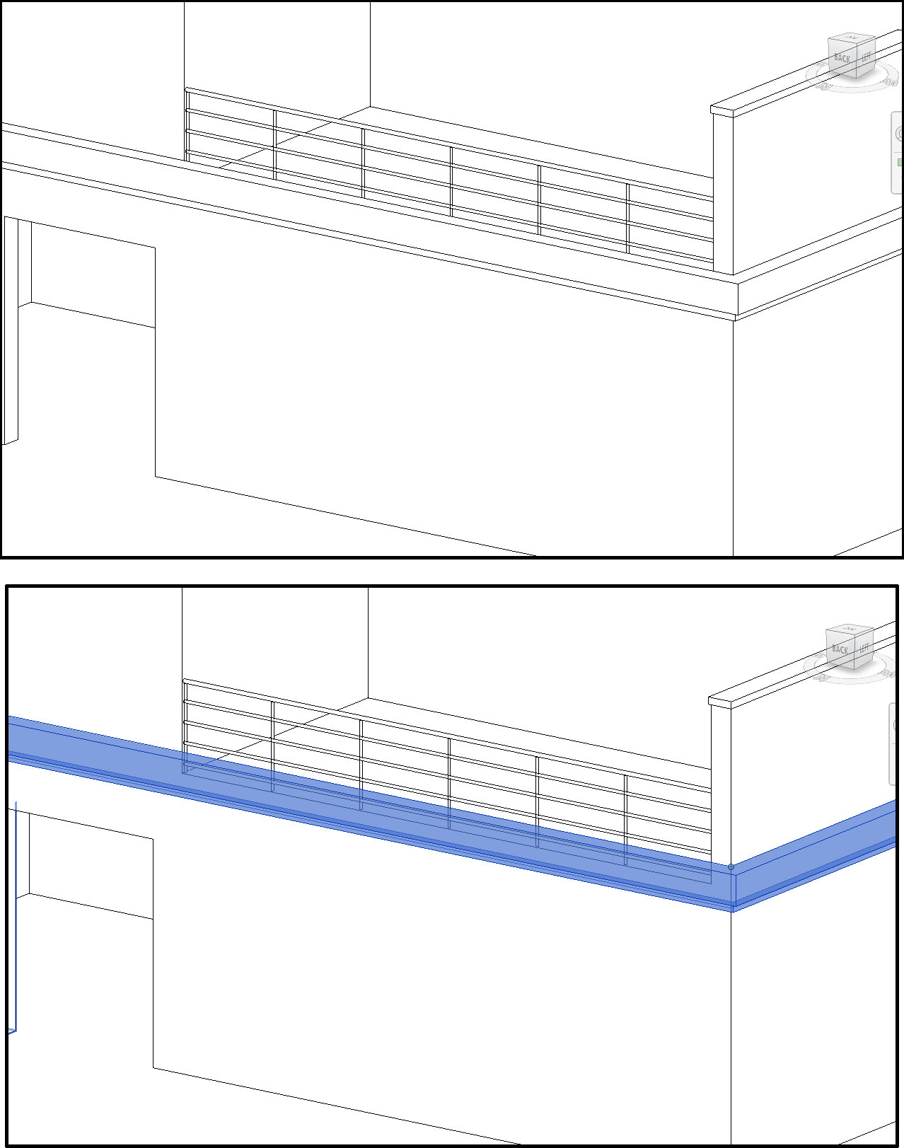

Hello there,
I create corbel profile for sweep around the house, just middle on the wall but it runs over the balcony. When corbel sweep through the window, it will cut automatic. I want it the same with balcony. Do you know how to do it?
Please see the picture.
I am awaiting to hear from you.
Many thanks,Bogumil
Thu, Feb 25, 2016 at 8:10:35 AM | Corbel Sweep through the balcony
Sorry, this will not cut.  Using the blue grips, you can pull back the sweep to one balcony edge, then add another sweep in the same place and pull that back to the other edge.
